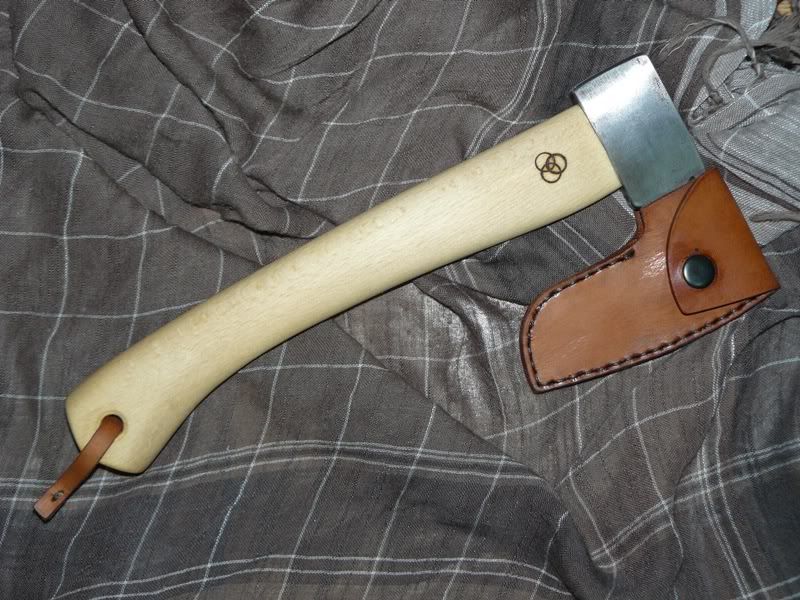

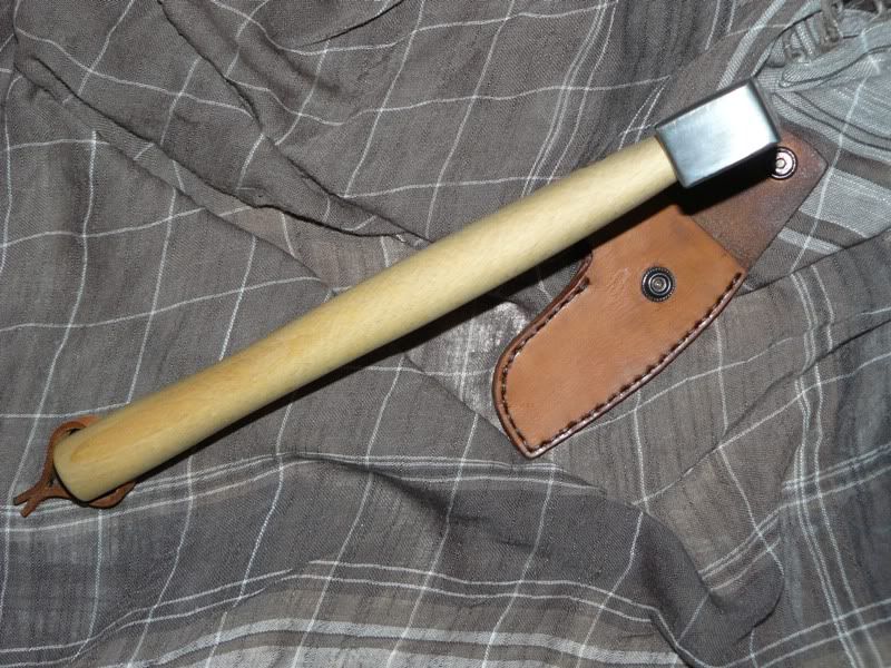

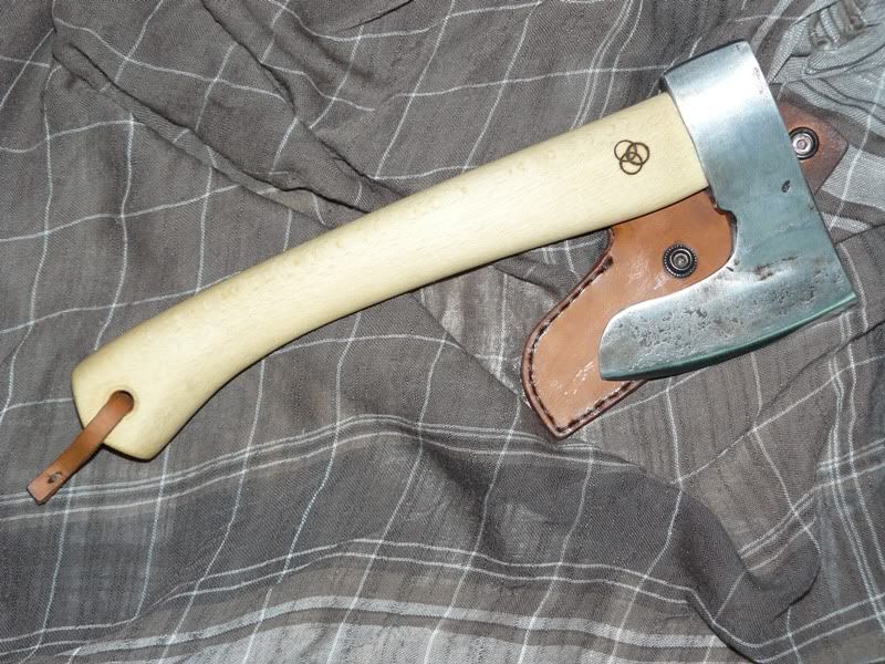

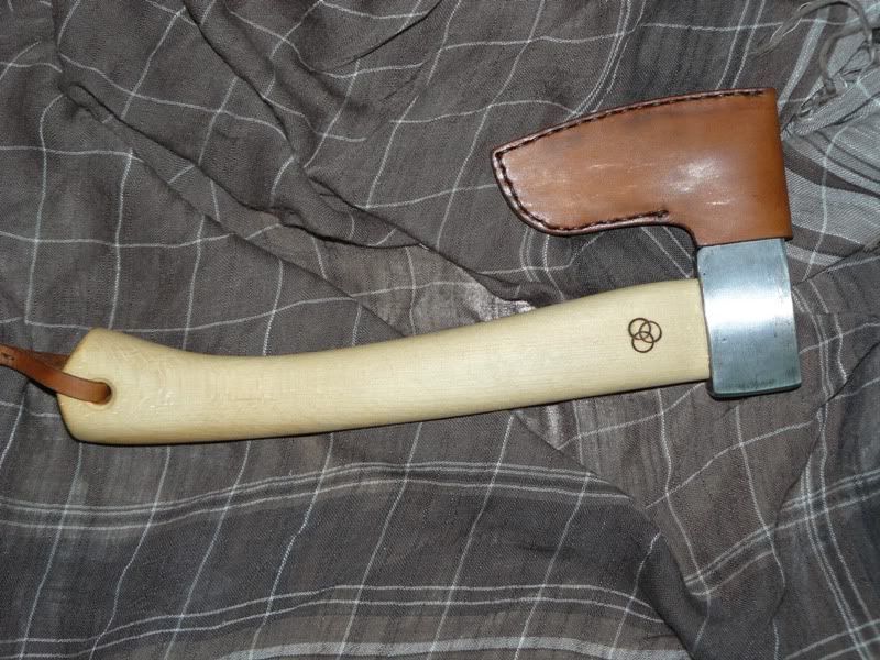

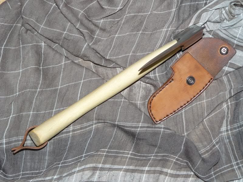

I completed a new axe, this time just for me. :)
I changed the shape of the haft but the head is made in the same way like Little bastard (a forged piece of spring steel welded on a low grade carbon steel head).
Overall, this axe is smaller and lighter than the previous ones.
Here are some pictures
And a video test.
http://www.youtube.com/watch?v=4VID96uYLdI
Hope you like it. :)

Overall is around 14 ounces, the cutting edge is 4 inch long and the haft is 12inch long.
