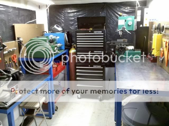

This is my setup as of a couple months ago.

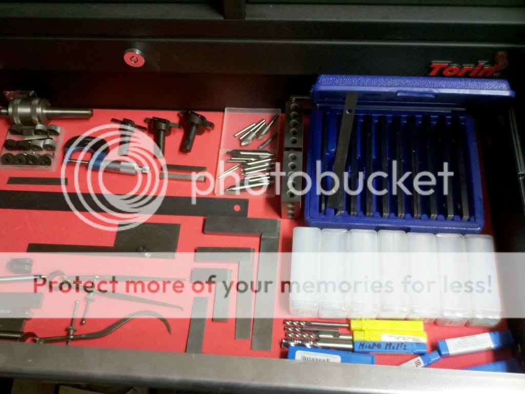

Ok, this is just real quick to get you going, once I clear off the tornado damage, I can get everything laid out and easier to see.
This shows most of the tools you'll need to do basic work, although some you won't use all the time.
Here we have,
-Parallel set. Used for positioning parts at different working heights in the vise, parallel to the mill bed or vise base. Also can some in handy as spacers and other things. Typically hardened steel, and meant to be precision tools.
-123 or ABC blocks, not a necessity, but handy sometimes for setup and fixturing.
-Precision squares. Just plain handy, and make fixturing parts much easier... plus they're nice to use around the shop.
-Center/spot drills. Used for marking hole centers, and also can be used to make detents for set screws.
-Fly cutters. Used for flattening large areas on a part. This is pretty much a must if you intend to use a mill for knifemaking.
-Machinist's rule and protractor. Used for layout, often marked in 50'ths or 100'ths. Invaluable.
-Centering tool/edge finder. Used to locate zero on the part. Not really necessary for many operations, but still good to have on hand.
-R8 collets, and various end mills. This collet set goes from 1/8 to 3/4. Pretty much covers the full range of this mill's capabilities.
NOT SHOWN
-Fixturing kit... basically a bunck of t-slot nuts, threaded rods, and clamps, used for fixturing parts to the table.
-Hand Scribe. Used to scribe lines on parts for reference during machining.
-Automatic center punch. Used to mark the center of scribed holes, to drill accurately
-Digital caliper (analog is also fine). Used for spot checking and semi-precision measurement of part's dimensions.

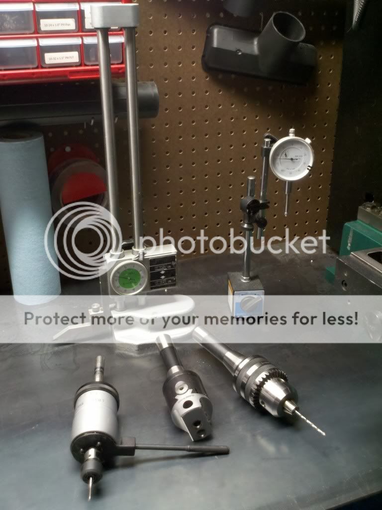

-Height gage/scribe. GREAT tool for knifemaking, and general layout. Used to scribe lines at a given height on parts. Must be used on a flat, stable surface. Can't live without.
-Magnetic base dial indicator. Can't have enough of these around. Used for precise measurement of actual part or tool position. Also used to make vise and fixtures parallel with mill way travel.
-Self-reversing tap head. Not necessary, but great to have.
-R8 Adjustable boring head. Allows you to make perfect circular holes anywhere from 1/4" up to several inches, with accuracy of .001" or better.
-R8 Drill chuck adapter. Allows the mill to be used as a precision drill press.

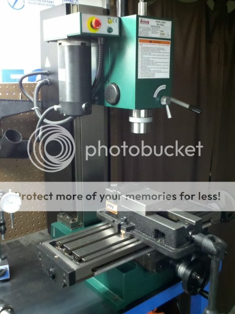

Here's the current state of my mill. I have a 4" precision vise attached, which is the perfect size for this mill (IMO). You can also mount a 5 or 6", but this one fits great.
