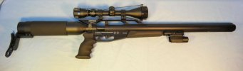

I have run a HF Mini Mill for many years and make all kind of stuff on it. Bigger is always better but if you do not have the room or ability to move the mill be sure to take that into consideration.
The first upgrade for the mini mill should be a belt drive.
Here are some of the PCP airgun parts I make on the mini mill. I sell them all over the world for these airguns.
You can do a lot with the mini mill if you have the knack
I use mine a lot. Sure a bigger mill would be better but it just is not an option.
