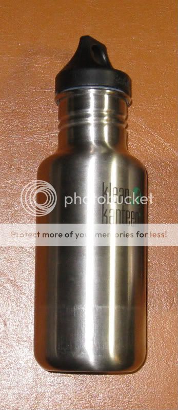

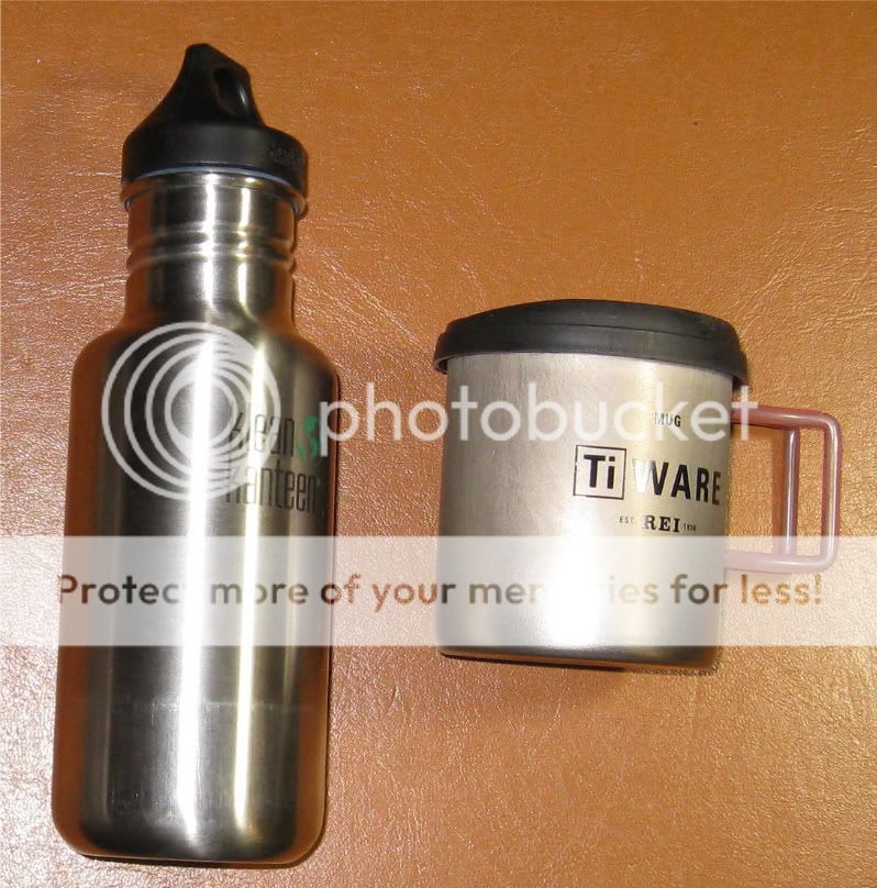

Bottle - I settled on the Klean Kanteen 18 oz. bottle. For size reference, it is about the size of a half liter water bottle. I went with the Classic over the Wide only because that was what was in stock locally and I was anxious to put this together. Here it is next to a standard 1 Liter Nalgene. The 18 oz KK Classic weighs 6 oz.

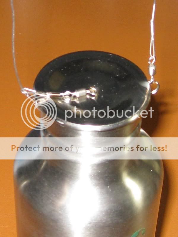

Bail - I created a bail out of a stainless fishing leader just as I did in the original Pimping thread. This gives me the ability to suspend the bottle over a campfire or to just hang it up out of the way.
Nesting Mug – The REI Titanium Mug (single wall) nests nicely. Unfortunately, the double wall mug doesn’t quite fit. I borrowed the sipper lid which came with my double wall mug which helps keep beverages warm and allows me to drink without searing my lips. The REI Mug and lid weigh 2.5 oz.

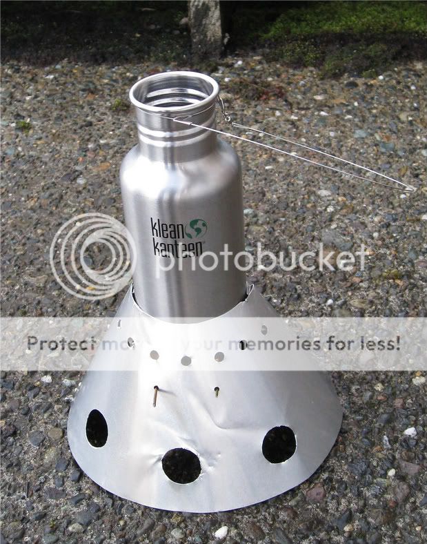

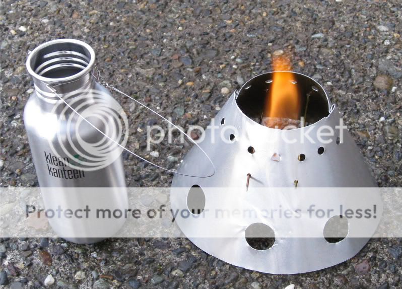

Stove/Pot Stand - Finally, I decided to try a “Caldera Clone” as a stove to boil water in the Klean Kanteen when a camp fire may not be desirable. The Caldera Cone is a popular but bulky backpacking stove/pot stand made by Traildesigns.com. After seeing this YouTube video on a MYOG clone, I decided to try to make one out of aluminum flashing.
It is essentially an inverted metal cone with two rods (made from a wire coat hanger) used to keep the bottle suspended over the flame. This version is designed to use with a Pepsi can stove or Esbit tabs. Depending on how this one works, I will try a wood burning version next.

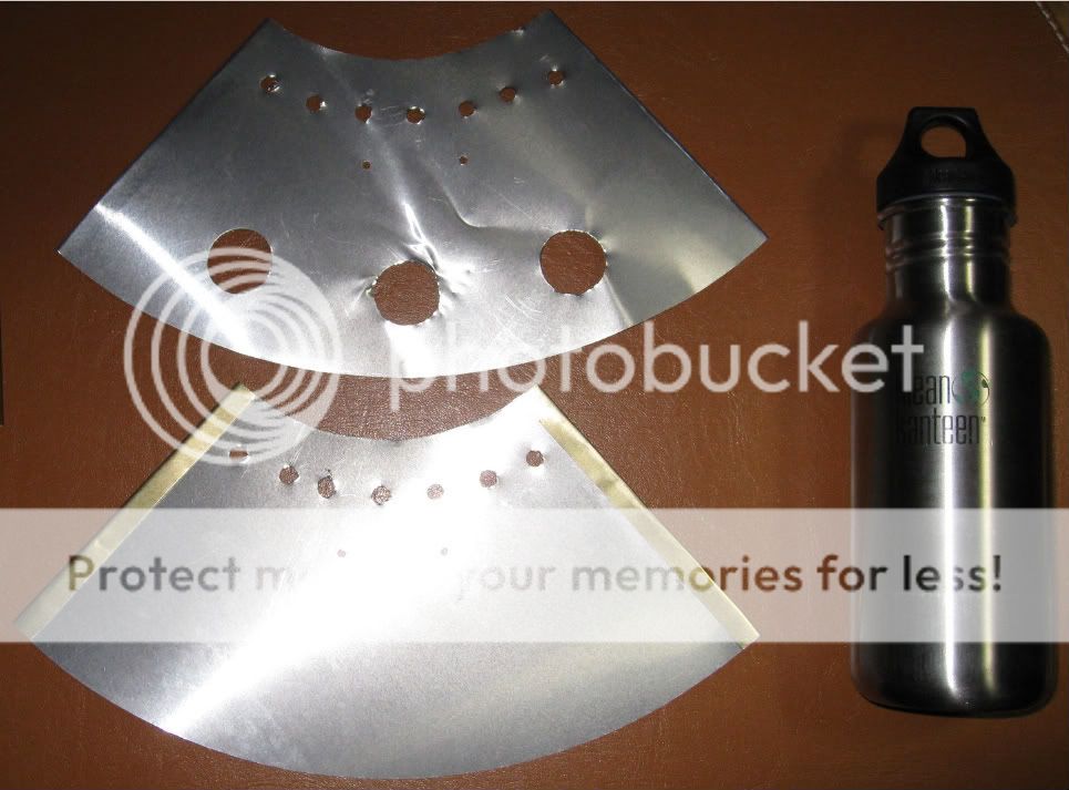

I made this one a two-piece unit to make it easier to pack. Each piece has a flange folded over on both ends, which mate with the flanges on the other piece. When disassembled it lays flat and measures 11” by 6.5”, which is easy enough to pack. It weighs a whopping 1.5 oz. (I have since made a three-piece stove which packs much smaller.)
I'll probably start a new thread on making the stove. Hopefully I'll do a test firing tomorrow and will have a boil time to share. A stove like this could be made for theh Guyot or any other pot. The YouTube video is pretty helpful. I made a pattern and a couple of mock-ups using manila folders before I started snipping metal. Here is the stove thread.

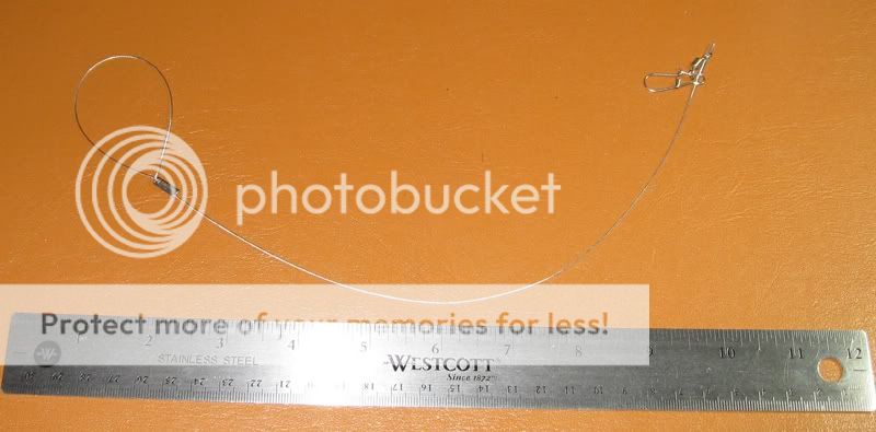

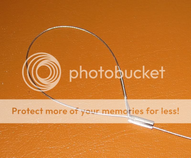

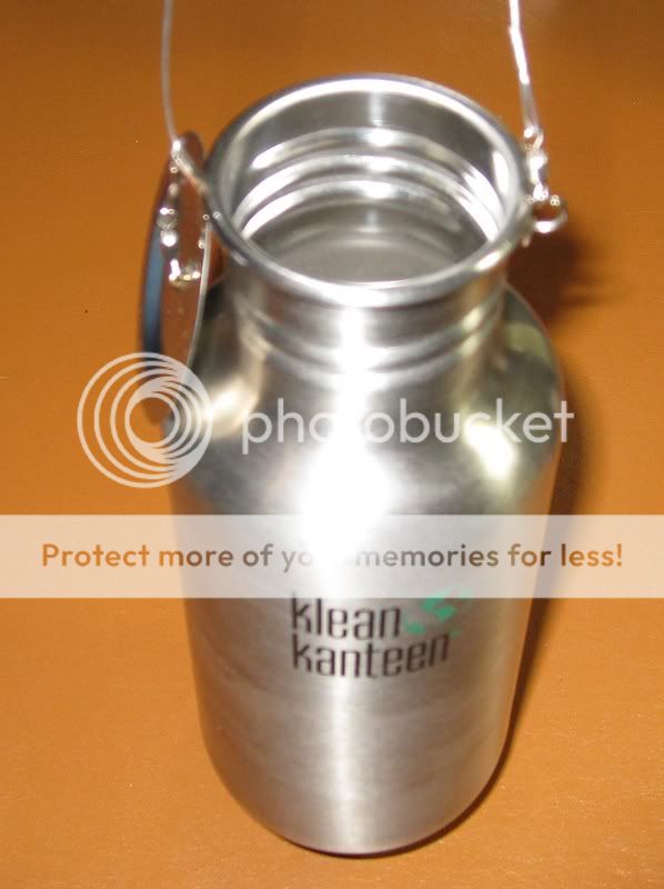

On the bail, I just used a premade stainless leader. I removed the snap off of one end, fed the end through itself, and then used a small crimp to hold the loop snug around the bottle's neck. It can either be used as a single line or can hook onto itself, creating a "bucket style" bail. The free end can also be attached to the cap to keep it with the bottle.

How are you attaching the bail to the KK?
It almost looks like something around the neck below the lip. Could you post a closer picture?

I might suggest,from an old version I made,is to eliminate the vent holes
on the bottom,and instead cut notches out of the bottom edge.
This will allow the cone to sit on 3 "legs" like
a tripod and be more stable on uneven ground.
I goofed in the picture,cut the notches so there are 3 total on both halves...
Anyway,great ideas pritch

Hi Dan,
Here is a close up. There is a big enough lip to keep the bail in place.

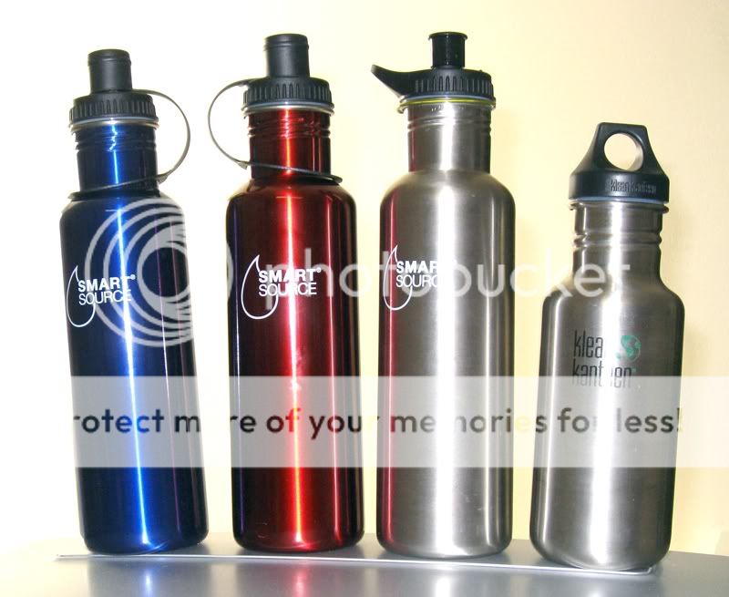

Finally, I came across a set of three 27 oz stainless bottles today at Costco for $15! (Less than I paid for an 18 oz KK a couple of weeks ago!) One was plain stainless and the other two were colored. All three came with black neoprene sleeves. The bottles are marked "Smart Source" but are made by Lifeline.
The sleeve adds a way to insulate the bottle and it is also nice to slip the bottle back inside of it after using it over a fire to keep soot and whatnot off of the rest of my gear.
The 27 oz. bottles are significantly taller. These won't work in the green pouch above but will be fine in my pack's bottle pockets.
The color is only on the outside of the bottles so they could still be used as emergency boiling vessels.
