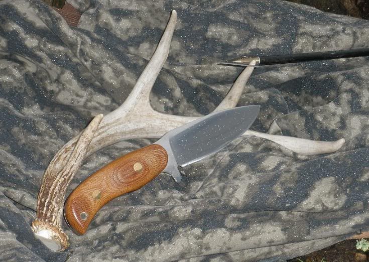

I picked up a couple pairs of black denim mircata scales a while back and just got around this weekend to putting them on a pair of matching blades. What do you guys use as a finish for them once all the sanding is done? Just polish with white or pink compound? Or would something like tung oil be better?
Since it's a fairly hard resin I don't think tung oil will really penetrate it very well, if at all. Stacy from here sent me some 3M polish cloths that go up to 8000 grit and that's what I used to finish this handle. It has a glassy finish as it is (hard to tell from my camera pics).
I finish fabric-based micarta in a couple of ways, depending on intended function. For pretty knives, I sand up to 600, then buff with green rouge. For hard use knives, I sand to 320 and leave it.
I also don't recommend oil. I consider a function of fabric-based micarta to be the fact that the exposed fibers absorb water when wet (without deforming the handle), making it grippy. I suspect that oil would prevent this from happening.

Her is some of my mycarta.

I'm not sure I can make a pretty knive Chris! These are hunting/skinning knives so a grippy grip would be a good thing. I have never worked with micarta before and it was jet black before I started sanding and now it is more of a dark gray or faded black so I thought there was something I was missing to bring back the dark black appearance.
