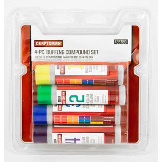

In the states, compound's like Ryobi's White Rouge can be found at Home Depot; it's usually sold in a set of about 3 compounds also including a 'yellow' compound that is intended also for stainless steels. I've also used a grey compound from Sears (Craftsman brand) that works very similarly, and they also carry a white compound that should work well. The grey compound is seen in the set below, labelled as number '2'. Their white compound is labelled as number '5', but not seen in the set pictured here:
spin_prod_947435312
If your friend searches the big-box hardware outlets like Home Depot or Lowe's, or Sears (going out of business soon, probably), looking for any of these compounds labelled for polishing hard metals and/or stainless steel is an easy way to find them. Don't worry too much about brands, as they're all pretty common and most any of them should work well enough.
