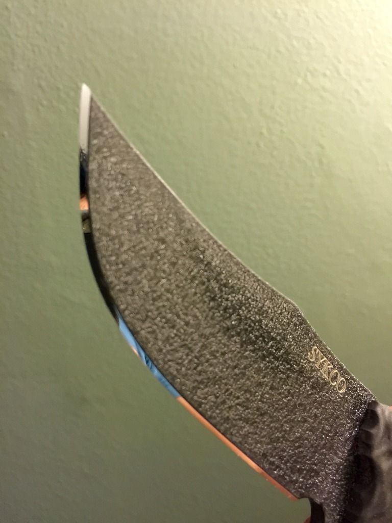

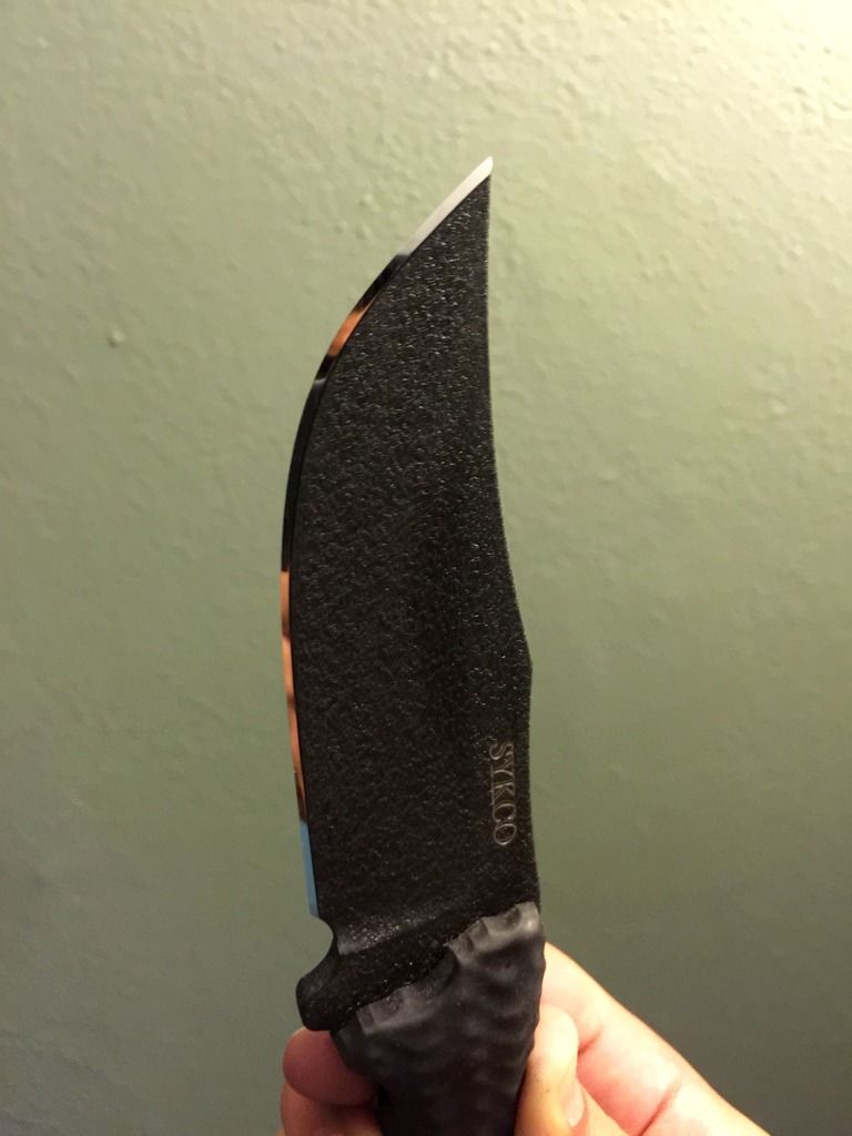

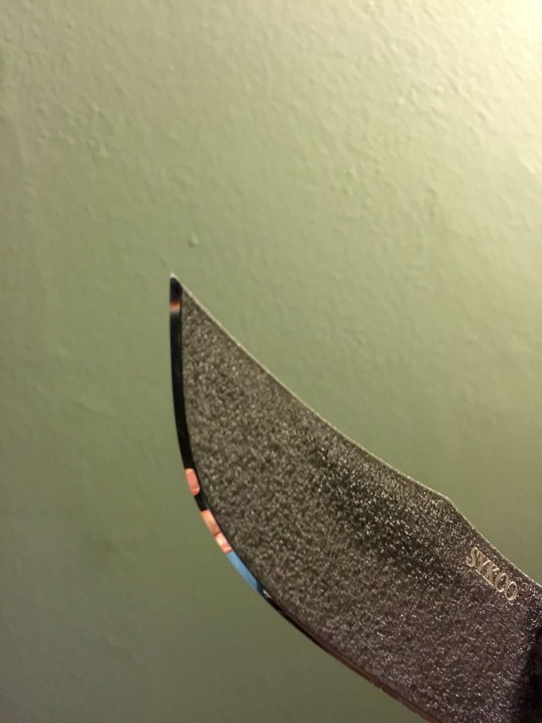

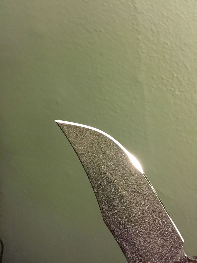

This thing is mean and vicious ---- I love it!! It was a pleasure to sharpen this small knife instead of the beastly NMFBM. I ended up reprofiling this edge to 15 degrees per side (30 degrees inclusive). It can cut! Just thought I'd share this wicked thaaaang

Nice. Are those flat or hollow?

Thanks guys! This edge is clean and as an apex thickness of .5 Microns. It's a V edge and it blends well into the secondary grind. I'm curious to see how the 15 degree edge holds up. I just know that for a 3/16ths thick knife --- it's slicey;)
Have you considered going to 8-10° per side with a 15° per side microbevel?

Hmmm ---- that sounds EXTREMELY slicey --- I may try that on one of my other blades to see how it turns out.

What did you use to do this?
Diamond Stones: 100, 200, 400, 600, 800, 1000
Ceramic Stones: 1200, 1600, 1.4 micron, .6 micron
Balsa Wood Strops: 5 micron, 3.5 micron, 1 micron, .5 micron
