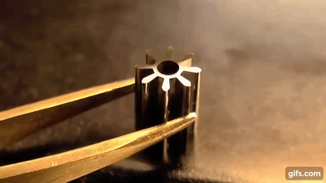

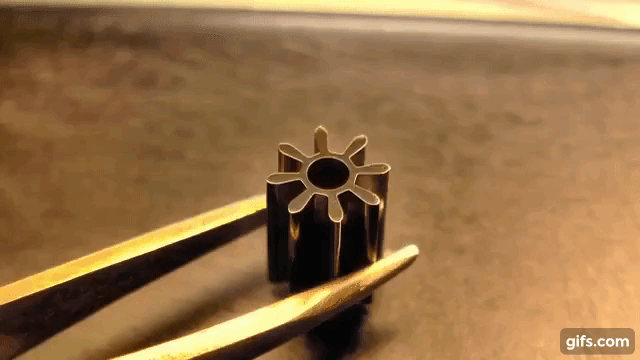

Hi,
What is cowhide exactly? Have you compressed the leather or is it with as-bought squishyness?
Also what is cloudy? Is the following image cloudy?
micro-convexing-from-pasted-mdf.1706583/
rounded on MDF (wood)
flattened on TIN (metal)
If you want increased flatness you need more rigid substrate
People who want increased flatness stop on wood, balsa, bass, pine ...
This is thin cardboard , is this shiny enough?
bodog post-13861992
bodog: if you call this crap

The knife job in thin cardboard impressed me beyond description. It's what I'm going for.
