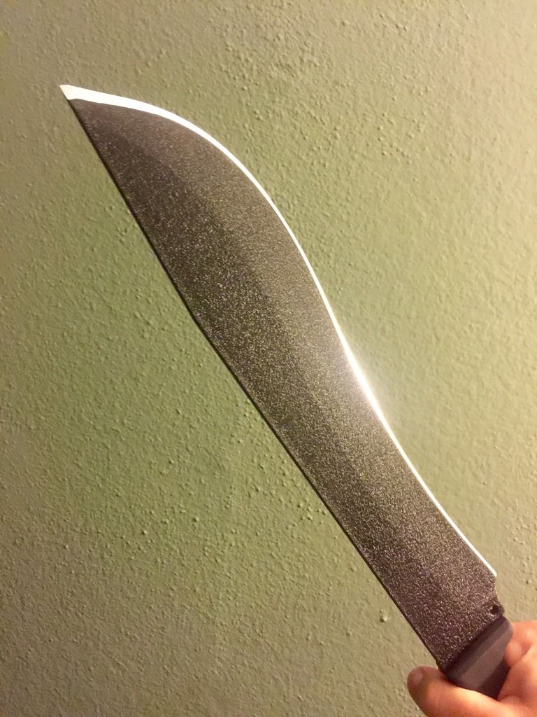

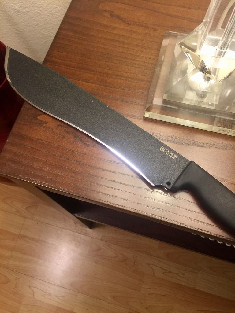

I think the BB13 BG/CG are two of the most exciting releases ever. The fact that the BG weighs 22 oz at 13 inches in blade length and 3/16ths in thickness --- means that this is a great candidate for a full day or more of wild excursions. We got a reaaaaal winner here!

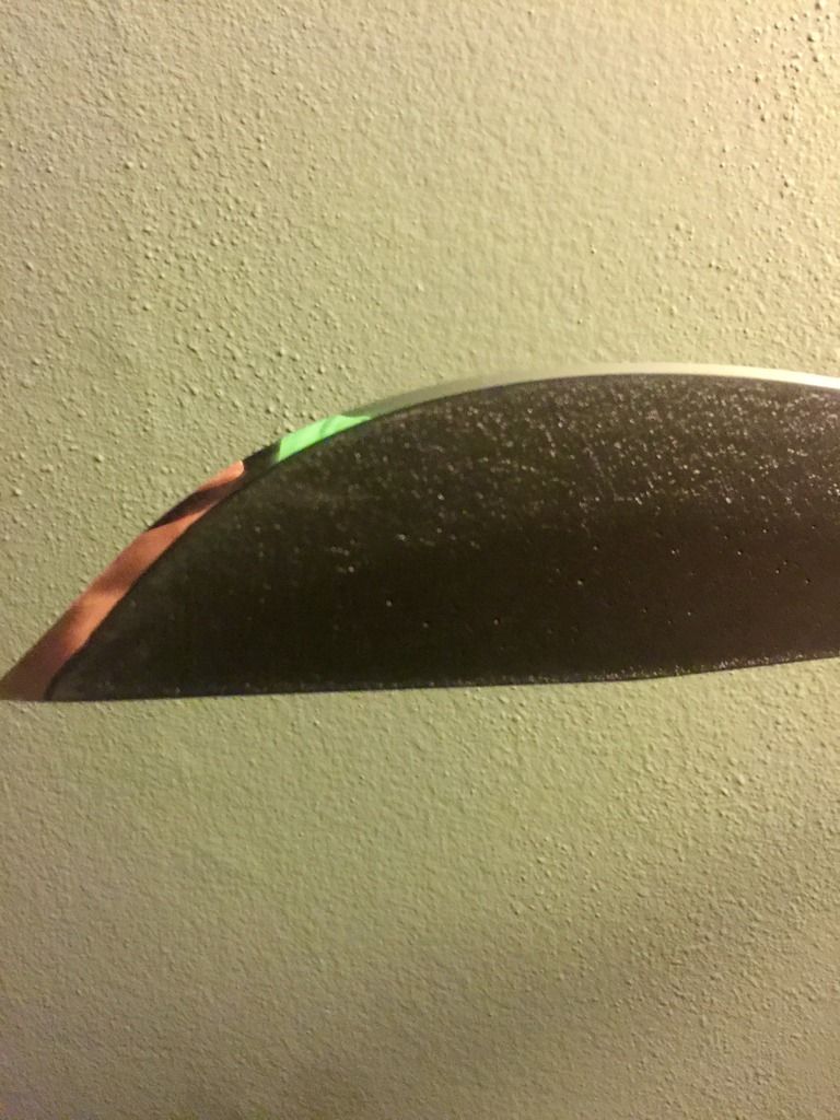

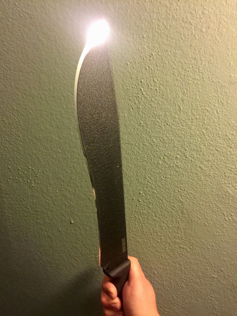

So ---- long story short, I wanted the Battle Grade as mean and thirsty as I could get it. It was settled --- she deserved a mirror polished edge and serious reprofile. A serious reprofile -- she sure got ;)
DISCLAIMER :: No flash photography here --- those light reflections off the edge are all legit ;)
Awesome looking edge! I'd love to see how she chops now. Is it still considered chopping if it cuts a tree in half in one blow? Or is that cutting?haha
Anyways, let us know how it performs. I'm very interested.
Awesome work Rob!!! :cool: :thumbup: Those tips are a bit on the thick side, aren't they? What angle did you sharpen this one at?
Damn Rob I wish one of my blades was as sharp as all of your blades! Amazing job as always!
Man that looks serious. I cut my finger just scrolling through the pictures. You made a mean blade look just....meaner for lack of better words. That just looks scary now, seriously. That recurve with that polished edge looks like the executioners blade.

19° per side?, or did you go lower??
Thank you Gents!! This monster is right in at 19 degrees with possibly an 18 degree tip. This tool is a fully functional one all purpose woods tool. It whittles hair across the entire edge and now has the edge/shoulder geometry to penetrate deeper. ;p
In case anyone is wondering . . . The Grit Progression was as follows
Diamond Stones: 50, 80, 100, 200, 400, 600, 800, 1000
Ceramic Stones: 1200, 1600, 1.4 microns, .6 microns
Balsa Wood Strops: 5 Micron, 3.5 Micron, 1 Micron, .5 Micron
