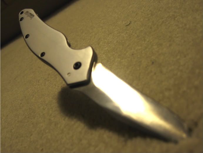

Wow this is some hard work! just as hard as it is to sharpen, it's even harder to sand down! Started on it last night with regular 400 grit and was able to get the coating off, but the steel wasn't completely smooth. I put the whiz wheel on it at work today and was able to get all the machining marks off the blade.
the knife was preowned and RichardJ had done his paper wheel on it. it looks okay right now with more or less a satin finish, but the convex edge really makes it look sweet.
since i started on it last night i've ordered some assorted carbide sandpaper and green compound. once those come in, I will resume moving up the grits.

not exactly mirror'd yet, but you get the idea!
also put on a black pocket clip to match the black screws. i hope i hope i hope this comes out good...

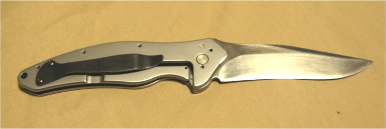

Well, I couldn't wait. Last night, I took my user apart and sitting on the couch I started in on it (everyone keeps sandpaper in their end tables, don't they? :confused:). Now it's done!
I started with 3M wet/dry in 320 grit and used that to knock down the stonewash. It only took about two hours. Then on to 400, 5000, 7500 and 10000 to smooth the steel out, and finished with some flitz. The blade finish looks like my satin ENER-G. The etchings are still there! All of this was done by hand in about 6 hours, taking my time.
I think you could easily mirror polish it from here with a power buffing wheel and some red jeweler's rouge. I could clean it up a little more, but I'm very happy with what it looks like now.

I'll try to get some pics up tomorrow. I've done everything without power tools. It could have turned out better had I put the buffer to it, but I'm happy with the satin finish. I may mess with some semichrome or Mother's tomorrow, but I don't want to lose the blade etchings. They are a lot lighter now, but you can still clearly read them!

Paper? 3M Wettodry, 213Q, A weight. It took a few sheets to get it done.
I don't think it's ever going to mirror up like aebl, cpm154cm, , much less the really fine grain steels. Like D2 with it's "orange peel" finish it will never get past a smoky, satiny mirrored finish without some real time, and going up just a bit at a time, not missing any.
Even then I wonder. This one is at a carbide percentage of near 23%, but a large amount of them are the largest, hardest kind.
