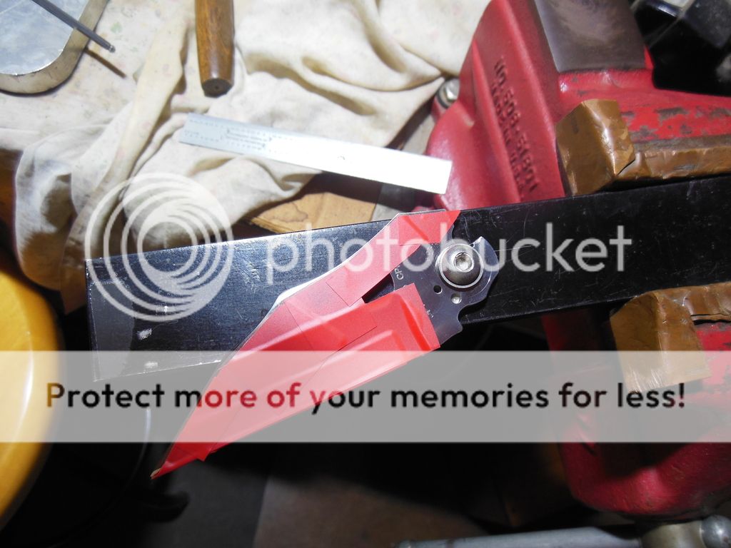

Yean, and how do you keep the crisp line between the sandblasted flats and the polished bevel?

It's just a whole lot of hours spend polishing, rubbing, and buffing. No secret to it.
Precisely.
In a pinch, any type of abrasive will work, but some are more effective. I use silicone carbide wet/dry normally. Tight grit progression. After 2000, rub with decrease grit compound. All by hand, I have found using machine tools during the process, generate hard to control air born contamination.
I make sanding blocks to aid maintain sharp transition and blade holding jig enable me to mount blade in various angle/position so as to avoid body contortion that can affect working comfort. Basically, improvise as needed:
The key factor in the process is to maintain area cleanliness and segregation between grit. One single grit will set the progress back.
