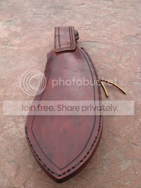

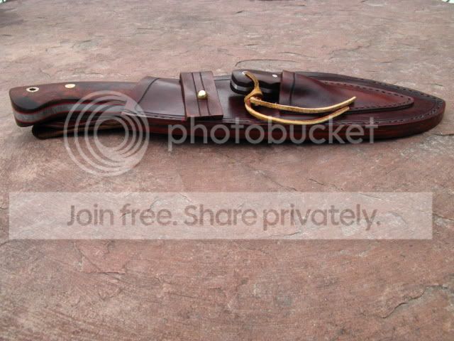

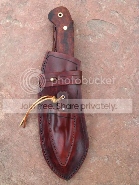

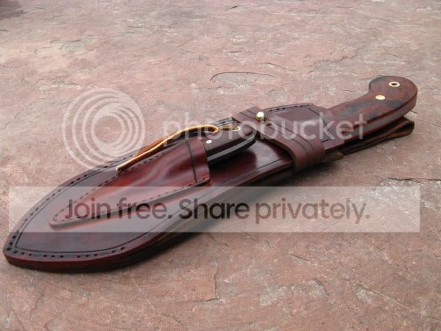

Just finished this up for the man. Fits his Koster monster nessie and fish knife. Both knives have desert ironwood handles. It's cloudy out today so the pictures aren't the best. I really like this set up.

This was the first time I ever did a piggyback sheath. The best way I could figure out to fit the small knife was to wet form the leather around the knife and then trim and stitch it on. I think that gives you the best possible fit. For the piggyback portion and the belt loop stitches I used nylon braided cord from Tandy. It's super beefy and my favorite material for stitches.:thumbup:

:thumbup: Nice looking rig. Quickdraw is definitely the way to go for a knife like this. I like how the leather color complements the ironwood. Also, the stitching pattern is interesting - two through every hold, then skip a hole?
Only thing I would modify would be the retention strap - maybe angle it to match the dark line scribed at the top of the sheath, and maybe trim the ends. I was thinking 45 degree cuts at the corners, each one removing about 1/4 of the end width. You'd still want enough strap to pull, though.

Yeah I thought about trimming the ends. I'll probably do that before I ship it out.
