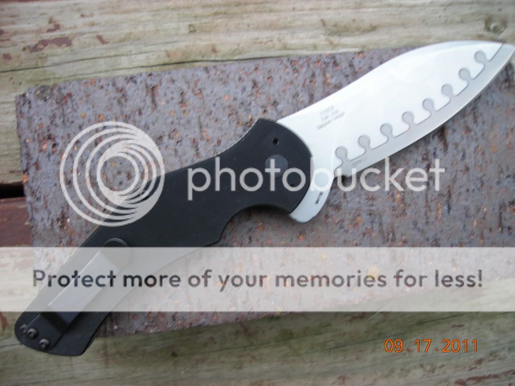

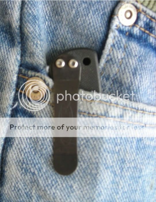

ZT clip on a JYD2 and a G10 Needswork. The Nw drilled and tapped easily but the JYD was took 3 bits.
They both carry much better IMO. And the JYD just looks better without the "bat clip". :)
Holy crap presz, those looks awesome! Great job! That really makes me reconsider buying a JYDii.
Get one! It makes the JYD II useable for me now. I have had them for years but never carried much because of the "bat clip" and tip down. The ZT clip makes it the perfect knife now.
They need this clip from the factory, and keep it black.
Presz, thanks for the pics, nice to see the finished product. They look awesome
