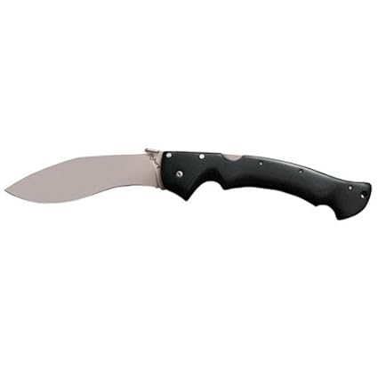

This is a pic of a mod to a spartan I found on the web. I would like to do almost exactly the same thing to my spartan. And also a very similar mod to a Rajah 2. Which looks like this. But I would want the clip lower.
Rajah 2.
You will need a drill press to drill straight holes for tapping. BUT if the liners are hardened, you will need special bits to drill through, and then tapping them will be a nightmare.
Fir the grivory, it should be easy enough to to with hand files and less likely to male a mistake that way. To do the final polishing maybe a dremel buffing wheel with compound would do it, but try it first on the flat inside face of the scale to see what the result looks like.
Ok, first order of business is to find out if the scales are hardened. IF the scales are hardened, I can't reasonably move the clip. And if that's the case I may not want to change anything and so I need to rethink the idea. If the scales are not hardened, I can plan to go to my gunsmith friends house for the clip moving work. I may just pay him to do the work, this kind of thing is nothing new for him. The rest of the scales and plastic can be done by hand mostly.
