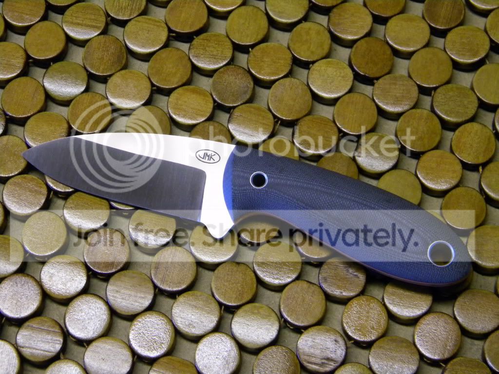

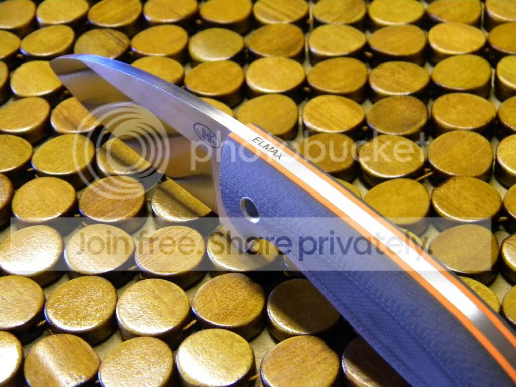

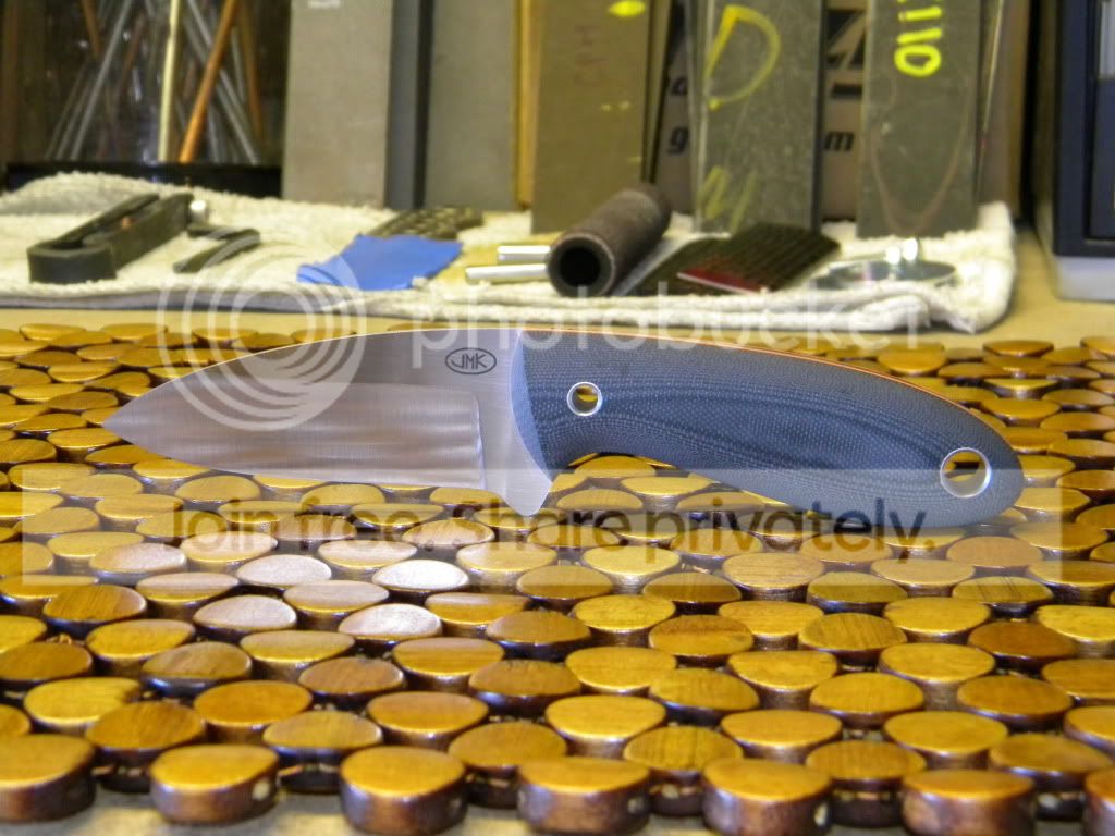

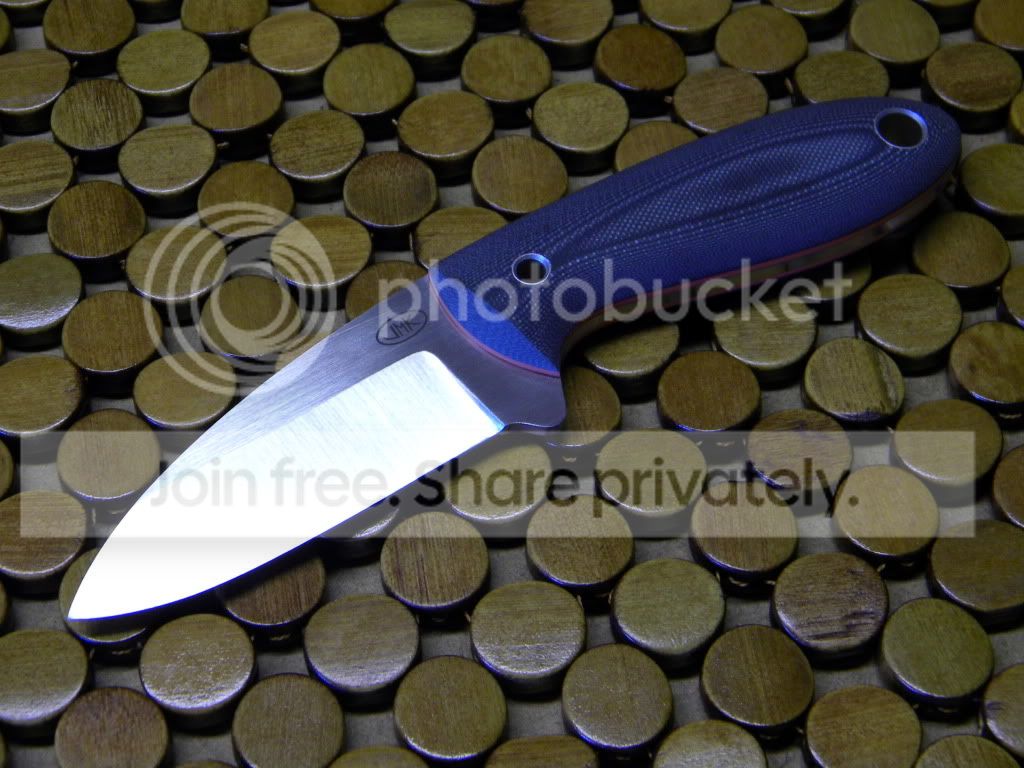

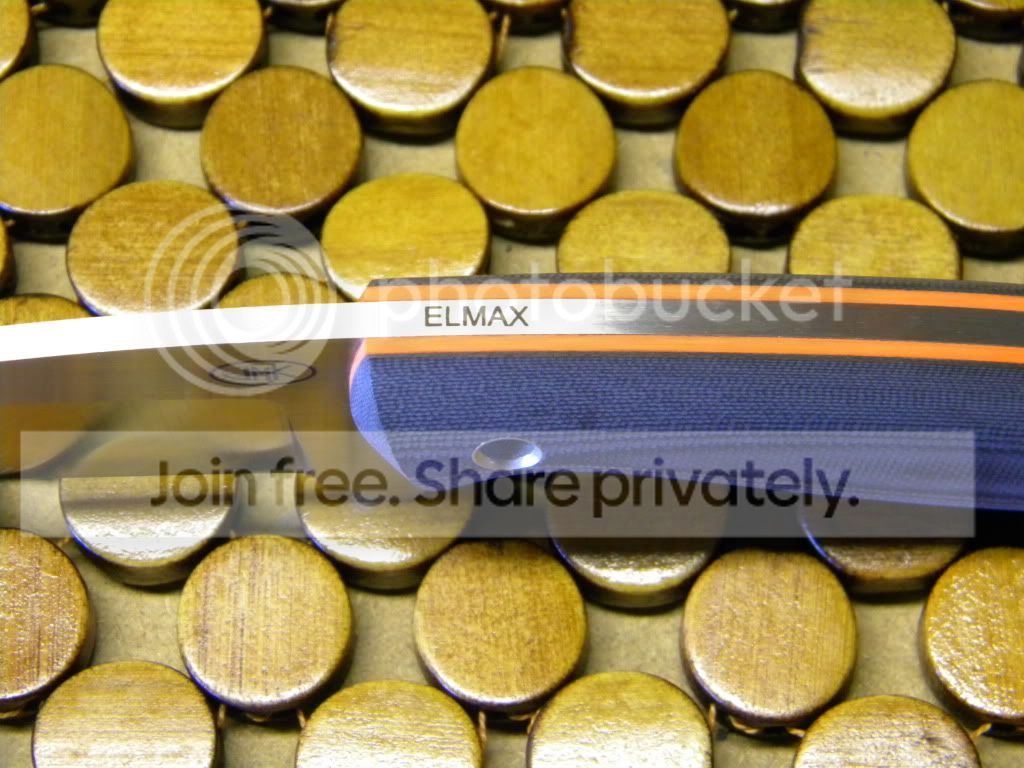

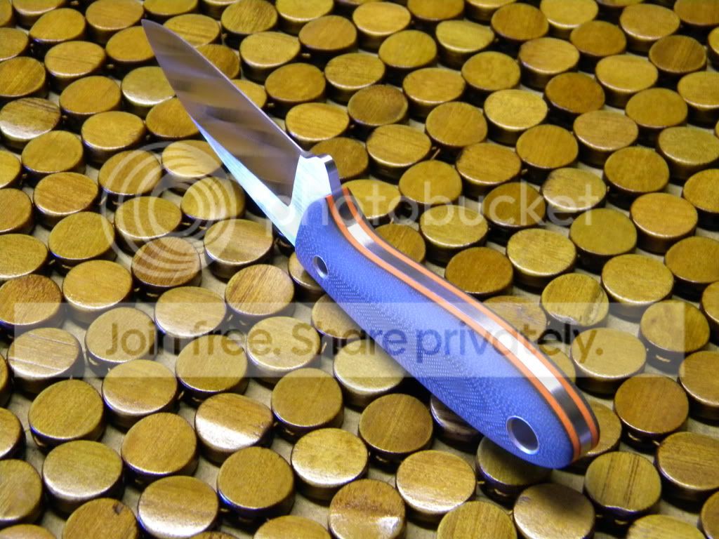

Had a forum member here get on my list a while back who wanted a model 1 without a swedge or jimping. He was just looking for a nice clean and simple blade with black g-10 and orange liners. Here is the result. I wasn't sure I was going to like it without a swedge but it turned out ok I think. Started out as .156" thick Elmax powdered stainless, heat treated by Peters to 60-61 RC, flat ground with stainless hardware.
Thanks for lookin!

Super clean as always. Are the scales bead blasted?
Jonny, I've always liked your clean grind lines. Do you use a jig or is that freehand?
Jason
Jason
I use a bubble jig from Fred Rowe to set my bevels at about 10 degrees, but after that it's all freehand.
Ben, yes I did bead blast the handles.
