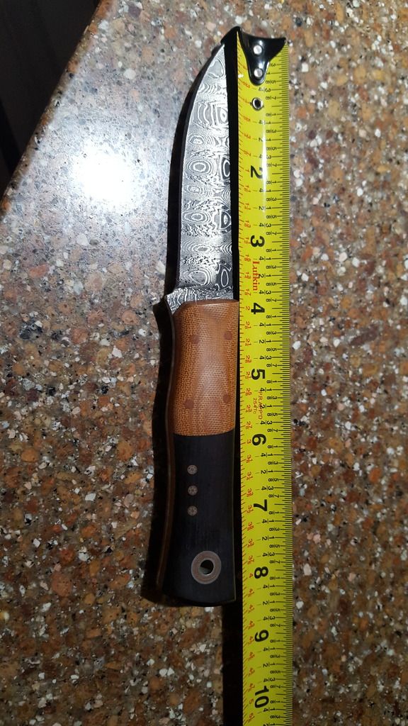

I haven't seen any specs on the Drop Point Renegade, but I have for the rest and just working on loading the spreadsheet onto photobucket so I can share on here!!
Sorry for the crappy pic.....and lack of actual numbers but you can get the idea
Cool!! I'll add to the info I just posted!!
Updated now.
I did see I missed Duke and Machete handle specs, but every thing else is there
