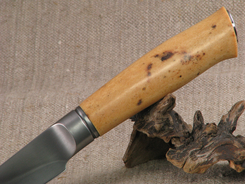

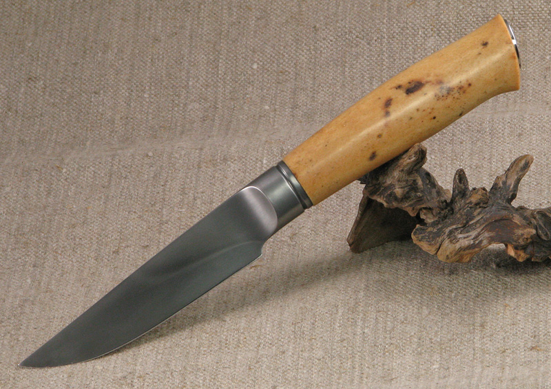

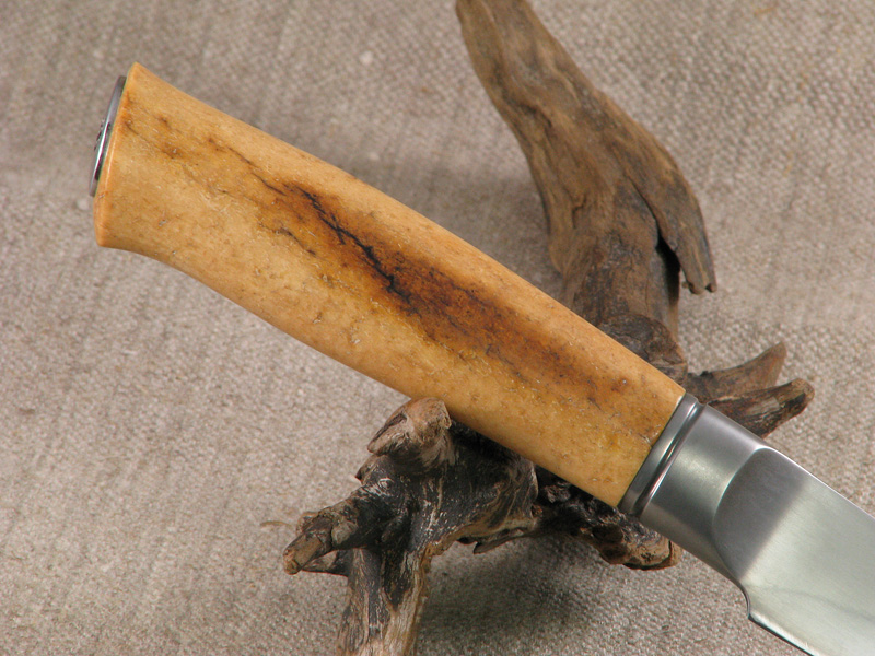

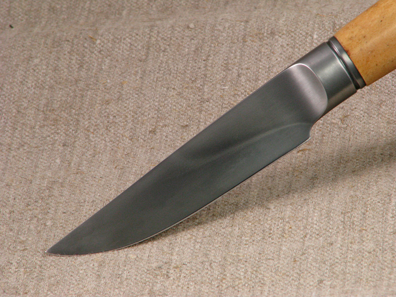

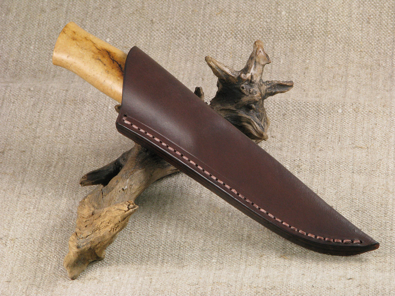

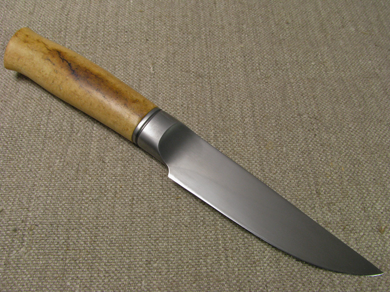

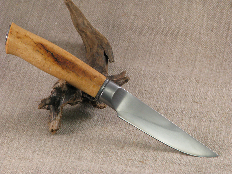

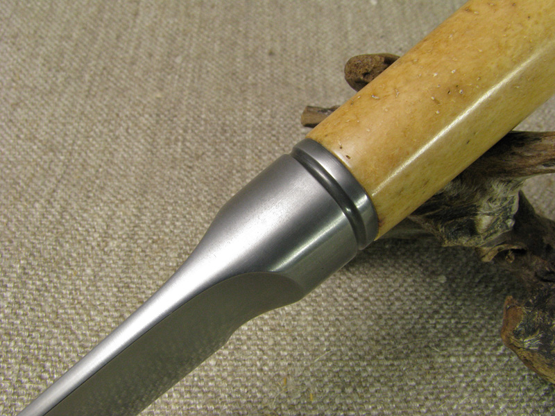

hello together,
here is a knife for my show in solingen next weekend:
it´s a sort of modern ´bavarian jagdnicker´, built as an integral with fossil seacow-rib
W1 forged
diff. hardened
60HRC
seacow-rib
tang internally screwed
buttplate with logo
total 23cm
sharp 10cm
thickness 3,0-1,5mm
thanks for looking!
gerhard
Beautiful.
I was looking at it (hadn't paid attention to who posted it at first) and thought "that looks like Wieland's work". Looked at who posted it, and sure enough.
Love your style man!
Perfect lines. A really good example of subtle curves creating a knife greater than the sum of it's parts.
