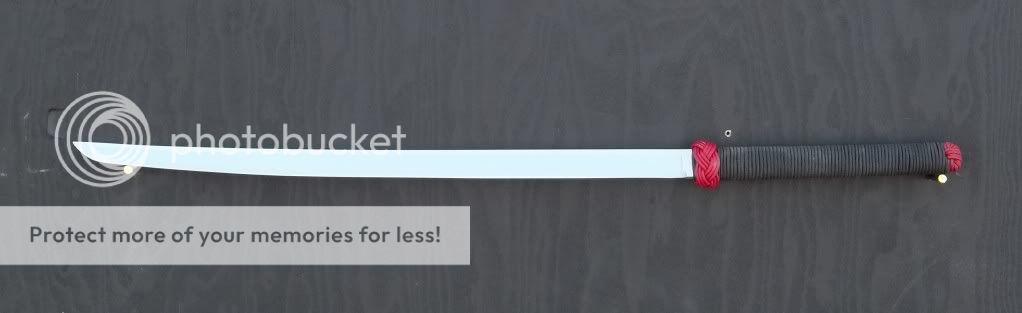

another low profile, custom ordered...
2lb 7.6 oz (that's 2.4 oz under the weight limit!)
36.5" oal 25" blade 0.255" thick distal tapered S-7 RC 58
That convex edge is really tricky to photograph so I gave up trying to get definition on the high shinogi in the picture
vacuum impregnated epoxy cord-wrap
I really like that one, too. Do my eyes deceive me, or is the curve a bit towards the tip (sakizori)?
- Chris
It is under my preferred weight limit, William, but that weight limit incorporates tradition mounting...If I were ever to own one of your swords, it would be with a eye towards competition, and that requires FULLY traditional mounts, say from the end of that Muromachi period mentioned above.
The blade featured above is somewhat short and thick, probably an excellent bush sword/stylized heavy use blade....what you do is quite intriguing, and I look forward to examining more of your work.
