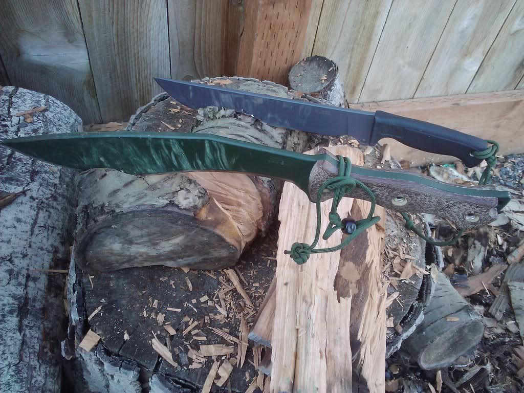

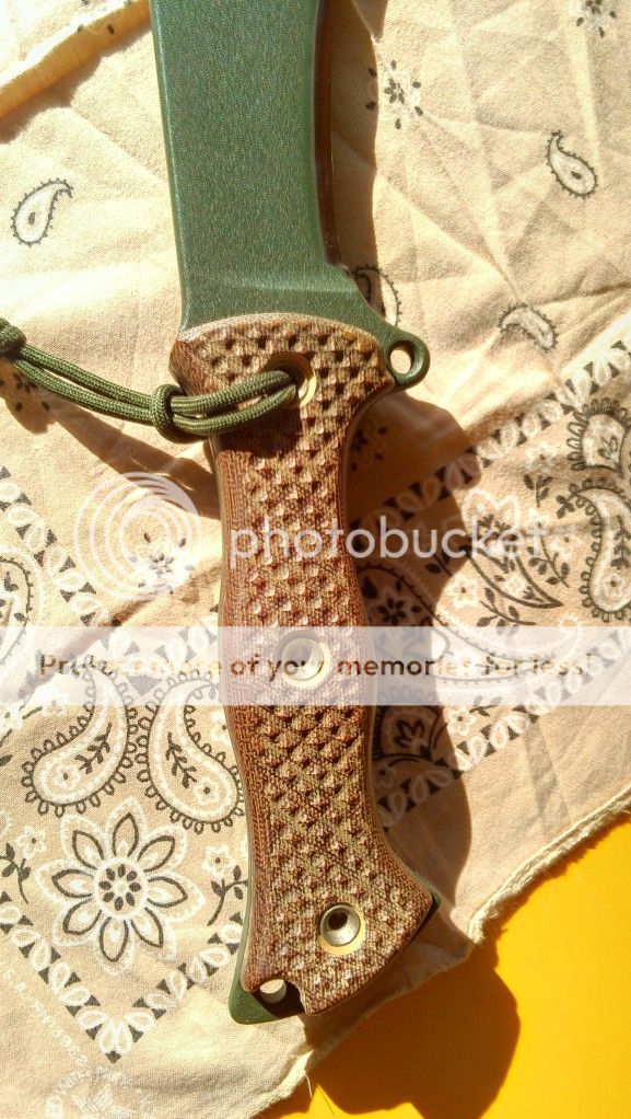

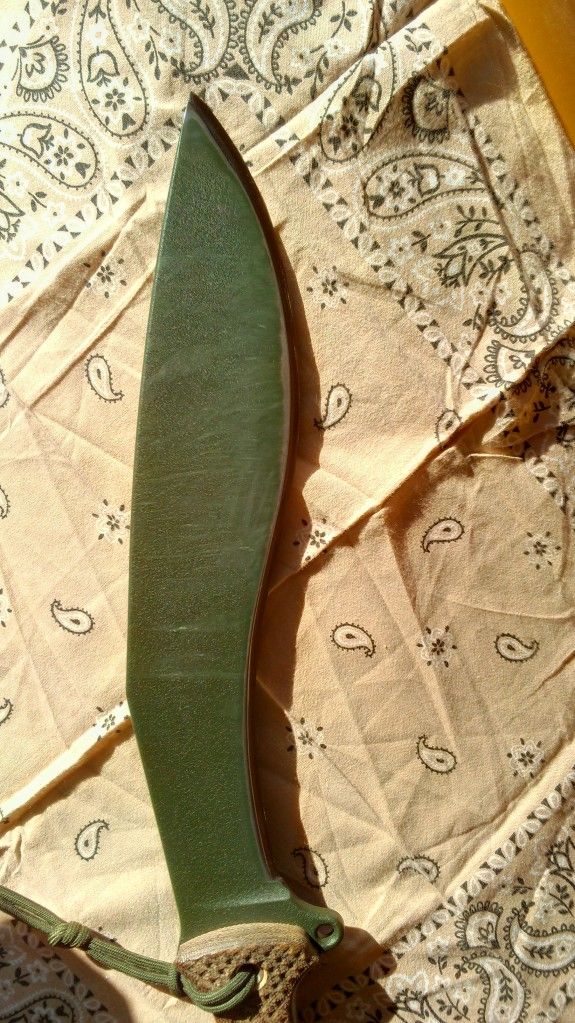

Busse Combat. They make two versions.
KZ and the KZII. 12 inch blade. .257 thick nearly indestructible Infi steel, guard. Micarta or G10 handles.
But pricy, and tough to find.

Thanks for the photos, and the good advice! I like the Busse designs, and this one just looks neat:
