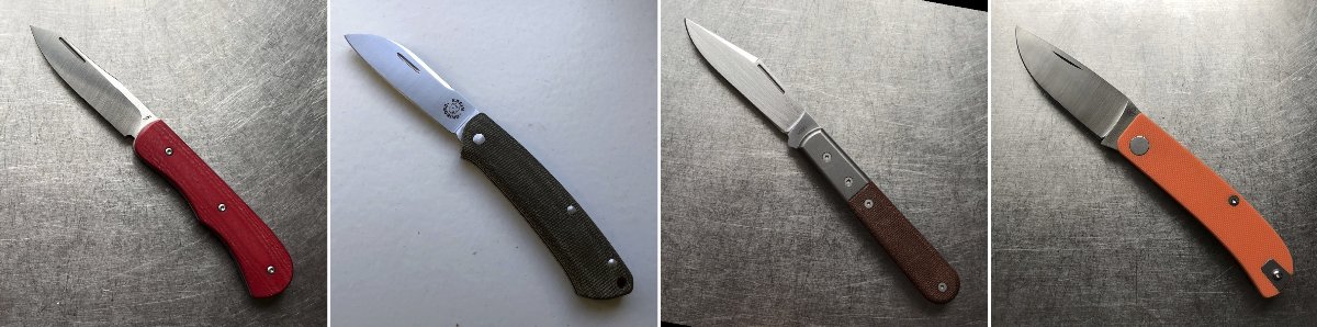

Otnat regrind Proper regrind
Overall length: 168 mm (6.61”) 170 mm (6.69")
Closed length: 97 mm (3.82”) 97.8 mm (3.85")
Closed width: 29.85 mm (1.175") 30.4 mm (1.197")
Blade Length: 73 mm (2.87”) 72 mm (2.83")
Blade thickness: 2.54 mm (0.1”) 2.04 mm (0.08")
Grind angle: 8.8 inclusive 6.4 inclusive
BTE at 15 DPS: 0.13 mm (0.005”) 0.23~0.34 mm (0.009~0.014")
Edge angle: Prob. 20 DPS 20 DPS
Blade material: M390 S30V
Blade grind: Flat Flat
Blade shape: Spear point? Modified Wharncliffe
Handle thickness: 13.14 mm (0.52”) 11 mm (0.43")
Handle material: Red linen Micarta Green canvas Micarta
Weight: 67 g (2.36 oz) 57 g (2 oz)
Nail nick: Double Single
Stops: One One
Pull (5 for SAK): 6 5~6
Pinchable: Yes Yes
Pocket clip: No No
Internal stop pin: Yes Yes
Price: $120 (+regrind fee) $130 (Reground ver. $200)
Shuffler Wasp
Overall length: 168 mm (6.61”) 176 mm (6.93”)
Closed length: 95 mm (3.74”) 101 mm (3.98”)
Closed width: 24.64 mm (0.97") 30 mm (1.181")
Blade Length: 74 mm (2.91”) 75 mm (2.95”)
Blade thickness: 2.54 mm (0.1”) 2.3 mm (0.09”)
Grind angle: 7.4 inclusive 4.8 inclusive
BTE at 15 DPS: 0.25 mm (0.01”) 0.23 mm (0.009”)
0.64 mm (0.025" original)
Edge angle: 20 DPS 15 DPS
Blade material: M390 S90V
Blade shape: Clip point Drop point
Handle thickness: 11.85 mm (0.47”) 16 mm with clip (0.63”)
Handle material: Natural Micarta Orange G10
Weight: 60 g (2.12 oz) 78 g (2.75 oz)
Stops: One Three
Pull (5 for SAK): 5~6 7
Pinchable: Yes Yes
Pocket clip: No Yes
Price: $120 $50
