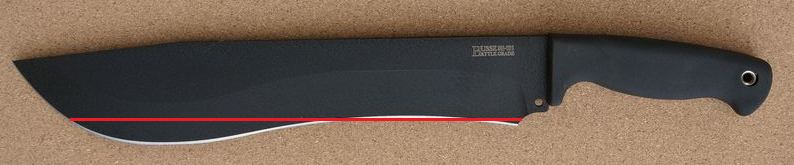

Hey everyone!
So I have this idea in my head to turn one of my upcoming BB13's into a Full Flat Grind with a straight edge. If I straighten the edge out i will be left with 2" of blade width which is perfect for a chopper IMO. Combine that with 13 inches of full flat grind INFI and - uhghghhhh i think i just made a mess in my pants...
I've thought about how this will affect the weight and balance. It should bring the sweet spot closer to the handle, someone around the middle of the blade length which is fine by me.
I am wondering if this is a good or bad idea to you guys as I don't have much experience messing around with blade mods. Be brutally honest, I can take it lol
That's the modification idea out of the way, now the warranty. Mods done to knives outside the Busse shop void the warranty as far as I know but what If it is done by a professional i.e Ban Tang, Josh at REK...does their work void the warranty too?
If it does, i'll just grind it myself if I decide to go through with the idea. So, grinders. Should I go for a 1x30 or 2x72?

My understanding was that unless the modification causes the failure, it doesn't void the warranty. And even if the modification does cause the failure, they'll still probably fix it, and put in in an ad for how good their warranty is. But that's just my understanding. Maybe someone from Busse will quit drinking long enough to give a more authoritative answer.
Your turning your BB13 into a Basic 11 + 2 so I guess it will be a Basic 13 then. Grinders, it depends if you already got one. I prefer my 2 x 72 hands down. IMHO it is not even comparable to a 1 x 30. But there is a huge difference in price if you have to buy those grinders.

The biggest risk is blowing the heat treat, leaving the steel near the edge soft/brittle. A lot of care would need to be used, I believe a coolant system and a good supply of quality belts the can be run wet would be ideal. The next big risk is grinding too thin. Once it's taken off, you can't put it back on :eek:
I agree with Ladams that a 2x72" would be far superior. I've worked with some large blades on my 1x30", (mainly machetes and my DTBM,) but with a bb13 you're talking about the removal of a lot of material and the larger the blade is, the harder it's going to be to keep it perfectly flat against the belt/platen and the more you risk gouging the blade.
What happens is when the blade hits the belt at angle, the contact area is smaller so the pressure shoots way up and the belt can cut a groove in the blade very fast, especially if it's a fresh ceramic belt in a coarse grit. Trust me, I know. :o If it happens early on you can "erase" those as the regrind progresses, but at some point you don't want to gamble on taking the grind progressively thinner to chase perfection, because you can't put it back on...
My personal anecdote is that I bought an 1111 that had been reground to full flat by a foreign maker. It was really awesome at first, but I beat on it like a rented mule and rippled the edge up into the primary. Then I kept using it anyway and eventually blew a half moon chip out of it.

Inkynate is 100% correct about the steel removal. Take it slow and easy. If you have a VFD on your grinder you can slow the speed to try and help, but that also causes problems in itself. It is very easy to put a mark on the blade you will have to learn to over look lol. I have a small pile of blades that are going to be changed because I made a tactical change in the grind on the spot lol. Well written!!! Or as the Millwrights used to say where I worked, "Beat to fit, paint to match" lol.

That's a lot of work, IMHO it would be best left to a pro.
And then you should assume that you would then own the warranty yourself, trust the INFI, and don't do anything too stupid. Enjoy.
I don't think I would do a mod like that, even if its done by a professional. How much weight would it actually take off? Why risk damaging the heat treat and voiding the warranty for a few ounces of weight. Get a Scrapyard 1311 off the exchange or i'm sure eventually there will a Basic-13 produced sometime in the future.
I don't have any pre-set plans to mod my BB13, but as a reference, the reground 1111 I had was roughly 4.5oz lighter than stock.
My quess would be that taking the BB13 to full flat could shave off half a pound, potentially more if converting to a straight edge.
I agree with banana-clip. Resharpening is one thing, but what you are planning could and would be harder and more difficult than just using another blade. Why ruin such a beautifully designed and executed knife to make it different when there are so many others to choose from? Of course it's your knife, so good luck! 😄

Whatever mods you guys do just make sure you keep the blade cool. Especially where it thins out. The edge can flash a high temp before you know it. I have done this kind of stuff on cheap knives. Just to see how hot things get. Even with a bucket full of water and ice and constantly dipping the blade was warm. Also use the roughest grit possible to take metal off. It produces less heat than the higher grits. And if you choose to send it to a pro, make sure to ask what it is that they do to mitigate heat when grinding down a blade.
Are they differentially hardened? If so, do you think you will take off enough material for that to be a factor?
I love mods. and I understand what you want to do, especially since I'm not a huge fan of recurves myself.... but that's not a MOD.-- it's major surgery!!! :eek:
Personally, I wouldn't tackle that one...pretty sure the BB13 will be through-hardened, but you're gonna be grinding into some deep virgin steel near the bolo bulge...
At the very least, you're gonna have a lot of thickness behind the edge in that area unless you plan on grinding down the primary flats there too.

The end result will be close to a 1311, from INFI. Except it won't, as the INFI BB13 is thicker than a 1311. So your idea will be unique. That's not a bad thing. I do appreciate the willingness of some folk here to make a blade their own. Your knife, your money.
