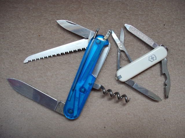

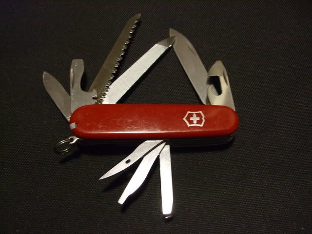

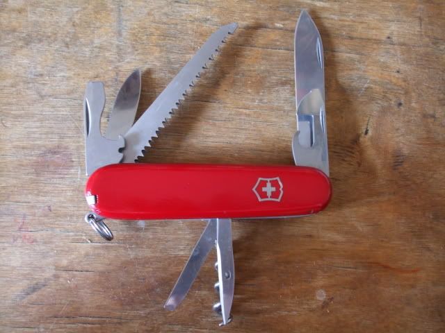

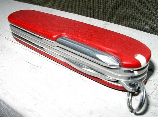

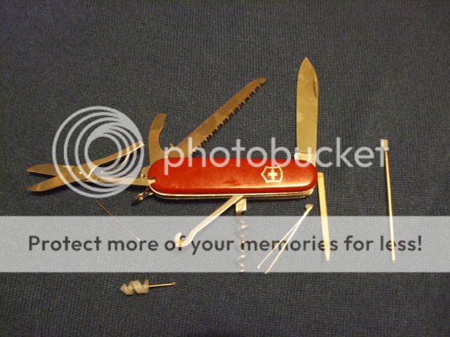

Here's some I have done.

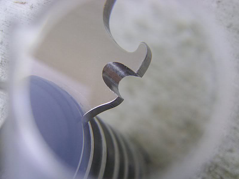

I like the wirestripper mod, how did you do that?
A started the shape of the groove with a small round hobby file. Once the initial shape was created, I did most of the work with a fine grinding bit on a Dremel tool. A have a Buddy who used to work for a federal arsenal. He gave me some totally awesome small grinding bits. I'd just grind a bit, dunk the tool in some water to cool things down, grind some more, dunk some more...... The Dremel work took about 15 minutes.

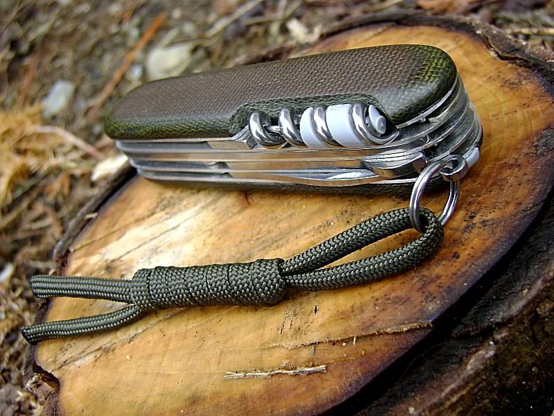

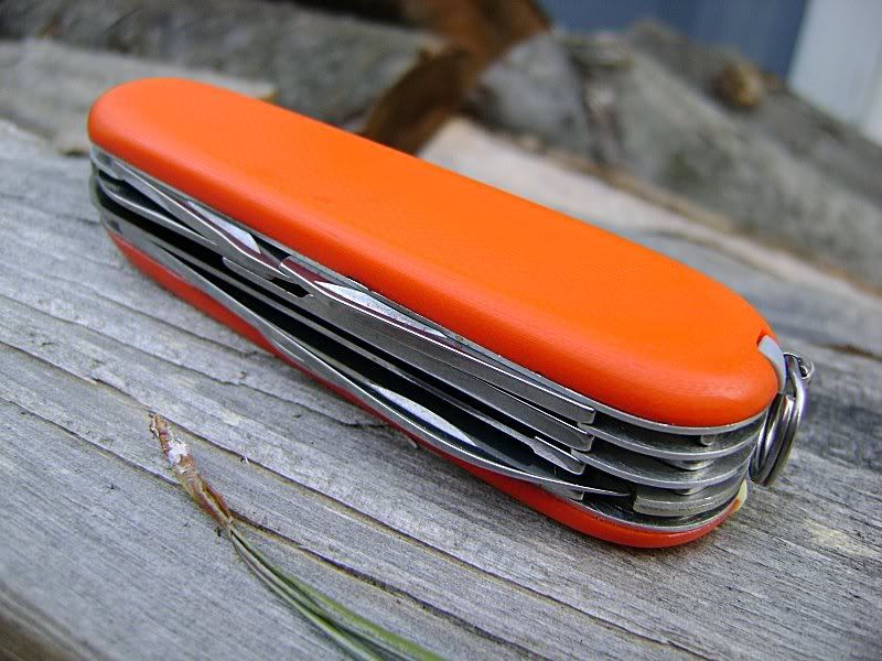

Buzzbait - share some notes on working with the micarta material for the scales? GREAT work there. I've done a few with wood, but I'd like to work in some micarta on some of mine.
thx - cpr
I've never done wood scales, but have worked with wood before. I don't think the procedure would change much. Saws, grinding bits and sandpaper work great on micarta. The micarta may dull things more quickly though. I do switch over to wet/dry paper for the finishing touches. The big difference is the dust. You need to wear a respirator when using micarta. The dust is nasty enough that I won't even do the work in my garage. I drag a table and chair outside, and work in the open air.

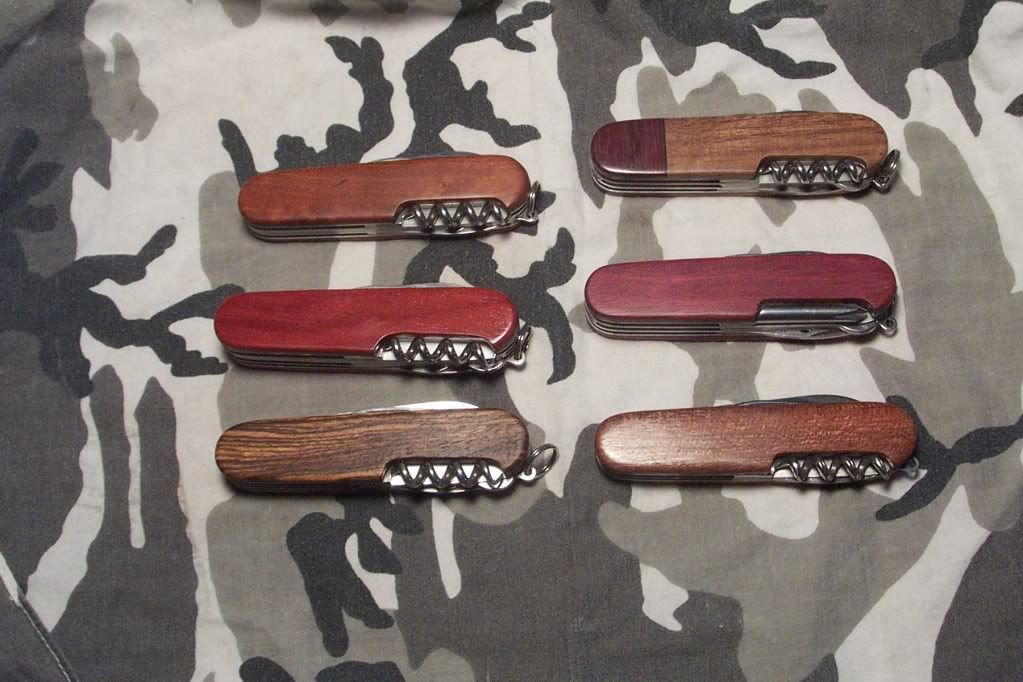

I did my first one. Still going to do one more coat of tung oil. The wood is Buckeye burl.
That is a nice piece of work. I like knives with wooden handles, it gives me a back to basics feeling.

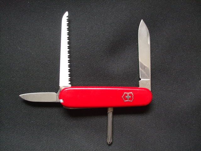

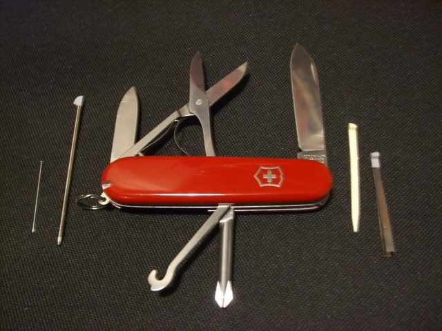

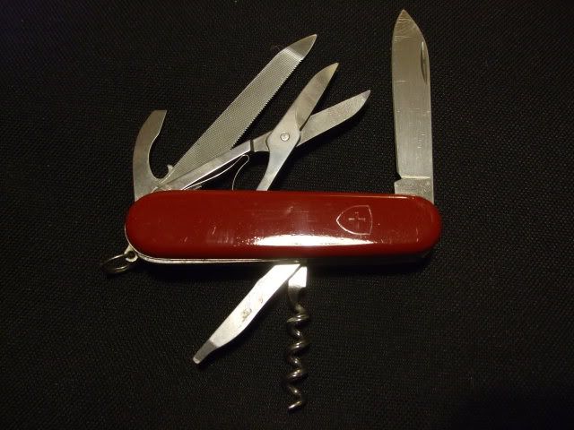

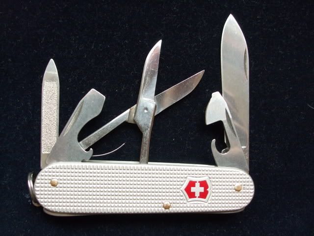

Here are some of mine.
These are all non-standard SAKs i.e they have never been produced by Victorinox. I've also done quite a few re-creations of rare and retired tools.
