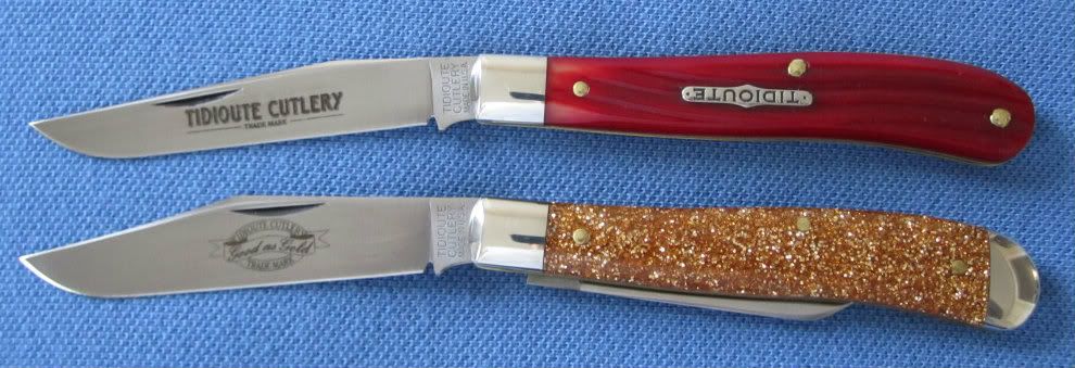

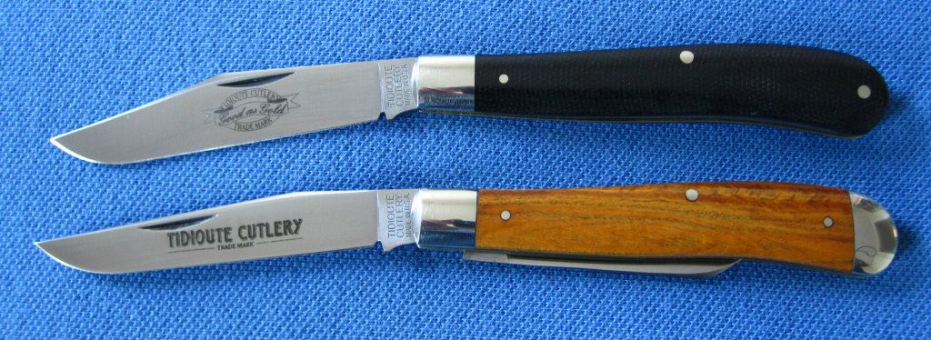

The #15 is a very popular pattern for GEC. I would suggest waiting until the next run or one pops up for you. If it was a less popular pattern then I may suggest otherwise. For example, I really liked the GEC #48 jack but wanted changes. I wanted a #48 with the slimmer clip instead of the full one. I went and got these 2 knives...
and had the main blades swapped (and covers rehandled by choice) to get these.

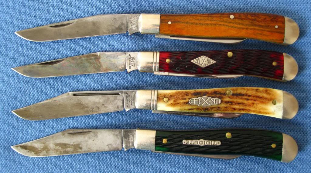

And I was happy. GEC didn't offer what I wanted so I had it made. Then Charlie came along with his DE line... and offered a slim clip on a #48 jack about 16 months later basically giving me what I wanted in the first place. After all that, I still ended up carrying my original green bone one far more often than any of the others... Here's an old pick of my user #48 jacks.
So while it can be done, I'd suggest just holding out a bit more.

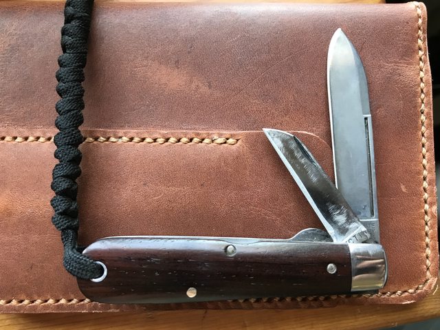

I actually have a spare spring and pen blade from from a cap lifter mod and at least a brass spacer, and maybe a steel one I’m not sure. It is often very difficult to preserve the original scales when taking a GEC apart as a lot of their pins are superglued in so it’s difficult to keep the punch from damaging or cracking them when hammering out the pins. I have been having increasing luck with it but it’s a crap shoot still. Maybe others have better luck or a better method than me. Hit me up if you’d like to discuss. That being said there are and will likely continue to be all manner of blade combinations available on 15’s.
Good old Big Biscuit. I ran across one of his posts in another thread, made me think of him. He sure liked his mods. He had a couple of 15s modded to very exquisit barlows with lovely wood covers, I think one even had stepped bolsters. Nice save from the broken saw on yours too. Makes for a practical blade.
Yes indeed, Bigbiscuit did like his mods and mod work. that 15 there third from the right was a gift from Bob when he had saw that I was too skittish to use the knife since they were scarce. I believe he redid the ebony on that one with much darker and beefier ebony. The tc is also a modded product from Bob's basement shop! RIP my friend, we remember you fondly.
