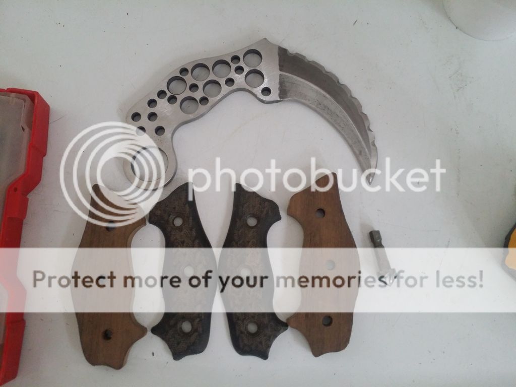

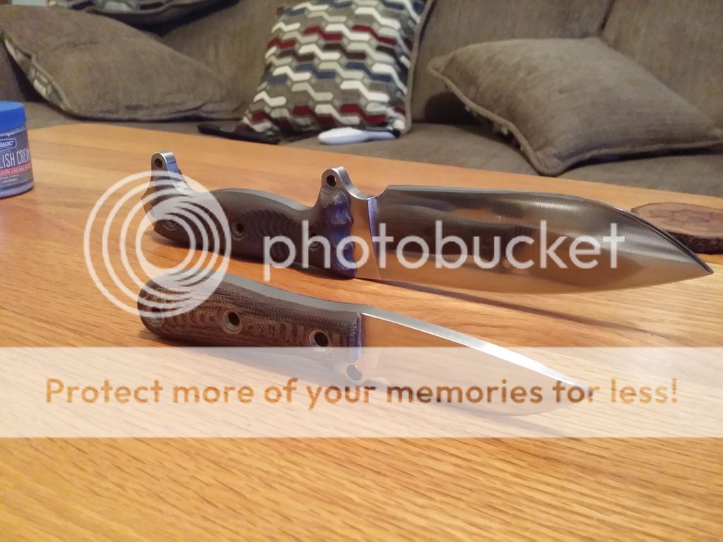

First up, my BB ASHBM. This came to me as a BIG finish ASHBM, and although I like the ASHBM in its stock configuration I felt there was room for some small improvements. I wanted to bring the balance rearward a little bit, to give it a more neutral feel in my hand.
So I pulled the scales, melted some antimony and cast it into the four holes in the tang. I also ground a blind bird beak into the pommel, because who doesn't think the BB looks cool? I had to take a little but of material off the inside of the grip near the talon hole as well to make the beak look more symmetrical.
Then on the top of the handle towards the ricasso, there is a sort of hump there, that on the old SHBMs is a small dip. So I ground a little bit out there to mimic the feel of the old SHBM better. After making new scales out of black canvas micarta, I installed them using some copper tube.

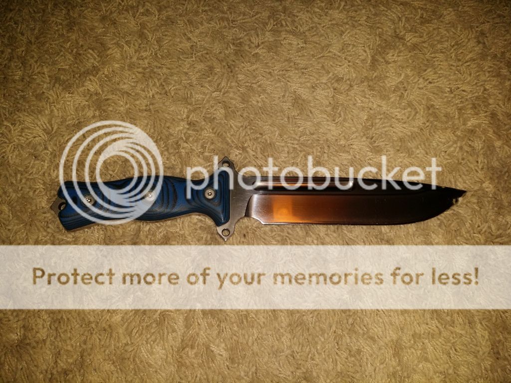

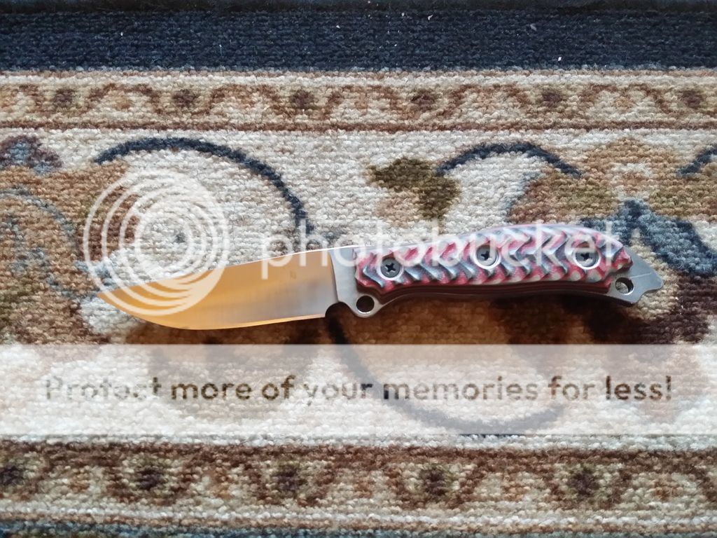

All I've really done is mess with the finish on mine. First I got rid of the tanker gray and did a DCBB type finish, then one day I got bored and did a little polishing on it.
She started life as a orange and black g10 handle

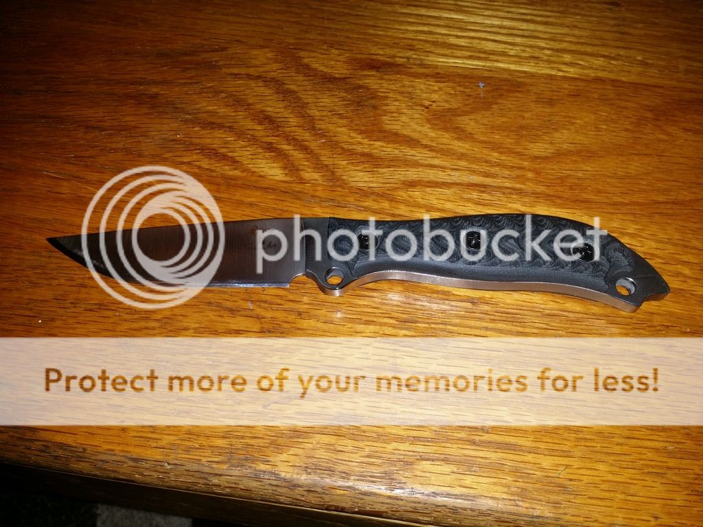

And this one was a comp finish with black canvas

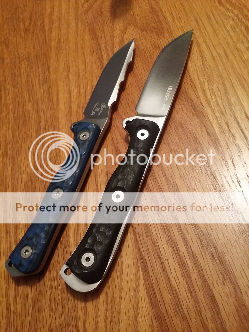

I switched these res-c handles, making them both the only ones I've ever seem with different color handles.
Mods to this include stripping and switching the g10

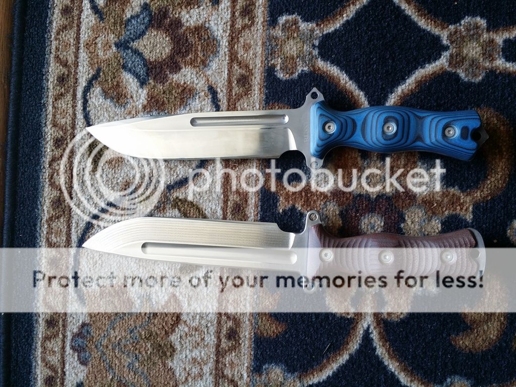

Stopped and polished out the double cut from this grail and then added the hand smoothed bruiser

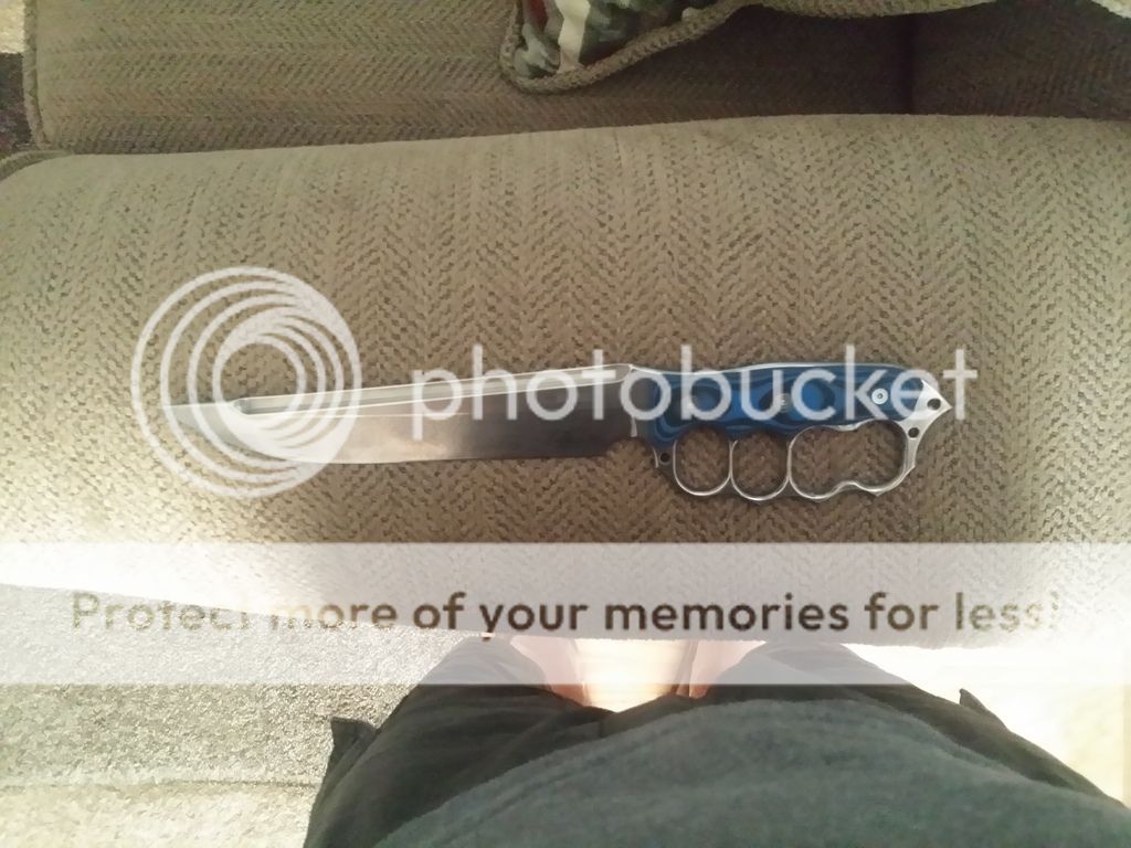

This is my stripper dssf with home made bruiser

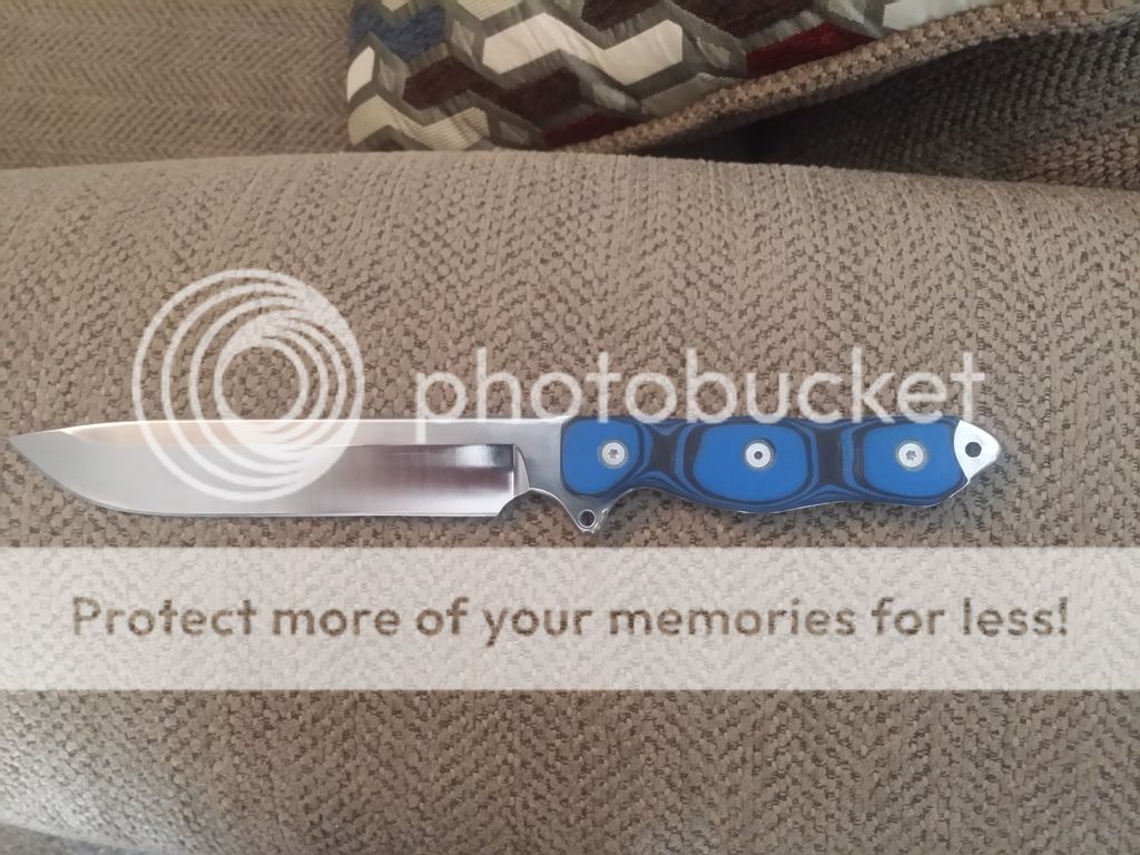

This amazing piece has been stripped and the edge has been revolutionized ;)
Anyone who has picked up a factory FFBM can tell you just how thick the shoulders behind the edge are on this mythical mistress. I consider this a mod when it takes that much work to optimize the edge and the shoulders behind it.

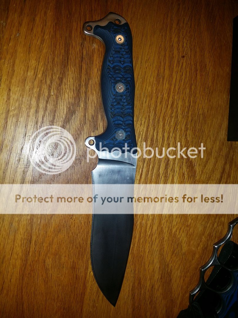

My next contribution, is a NMFBM that started life as a black G10 on black CG made from an LE blank. I stripped, sort of satined it, thinned the shoulders down , and made new black canvas scales attached with brass tube. No major mods on this one, other than going from the factory mags to the slimmer scales I made.

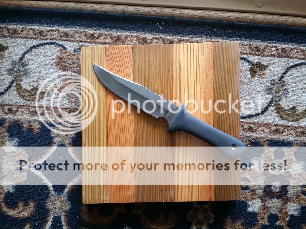

Butt mod, etched finish and swedge.
