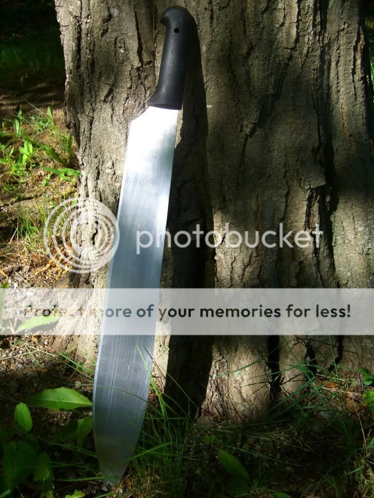

Just finished this up today. Out of the mods I've done so far I think I actually like this one best! It started its life as a 24" Imacasa Cuma--and I'll post pics of the removed hook later. It balances about 6" in front of the grip and broadens slightly toward the point, and feels nice and nimble with a big sweet spot. As much as I love a hooked blade, this modded version would be much more versatile piece to have in the woods! The blade is 19" now.
Since you're in Costa Rica I presume you're asking why the base of the blade is sharp? If that's your question it's because you can choke up on the blade quite nicely for whittling/making feather sticks or using it like the base of a chef's knife. The balance ended up being nice enough that you actually have a good deal of control over that section of the edge. To facilitate doing so I radiused the area where it flares out so it doesn't bite your fingers when choking up on it. :)

Looks nice. Almost exactly the Hansa Barrigon machete. Surprised that the tip is gone, I thought you were crazy about the downswept tips!
That's 'cause this one isn't for me. The big guy is still in production and I can get another from Machete Specialists anytime. The smaller one I can't replace, and I like it better. That one stays stock and I'm keeping it close. :cool::thumbup:
Here it is with the section I lopped off the tip. I'm probably gonna make a neck knife or something out of it. :)

I took some more pics to post in the thread on the exchange forum. Thought I'd show 'em here too since they came out so nicely!
When I was testing the edge out on it at my folks' place (I use their basement to work in since I don't have anywhere at my place where I can use/store power tools, vices, etc.) I was going through stuff 1 1/2" thick in one chop! I'd like to see what it could do food prep-wise, too, but I figured it'd be unprofessional to do so! :D

I just figured folks wouldn't want me to do food prep with a piece I was selling. I can tell you right now, though, that this thing balances almost as well as a chef's knife. :thumbup:
That looks like a real workhorse general purpose blade, much more so than the special purpose hook it was. That is the cool thing about machetes. There is always a right one for the job but sometimes it's contained in another blade. You did a good job onthe mod. Now it's begging for a sheath and some dirt time. Mac
