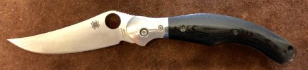

just a sneak peak of my modifications to my Hungarian.
I really like the grind you did. Any chance you’ll post a pic of the whole knife open & closed?
Perhaps a little less ethnic, but a lot more practical...
The Hungarian is a very underrated model, IMHO. I especially enjoy the ergos of the handle...kinda Opinel like but very very comfy >>> nothing else like it in the lineup for Spyderco.
How'd you remove that top quillion? It appears you did a great job keeping the lines consistent. Looks factory from where I'm sitting! Reminds me of how I modded my Schempp Bowie.
I bought the Hungarian with the intent to modify it. No offense to the designer as I know he was sticking to the ethnic profile, but it wasn’t comfortable and looked like a penis. Also, the blade shape didn’t match the handle. Looked like two different knives combined together. Just didn’t flow. I took the top off using a belt sander, dremel, and files.
It’s your knife, this was another near miss for me. Is it just me or does it look more like a Military now?
The blade certainly looks Military-ish, as Yonose notes. Should be a superb slicer. CTS-XHP will take a very fine edge.

You should have gotten one. The build quality and intricacy are outstanding, but I just feel the execution of looks and ergonomics are lacking. Unfortunately, as part of the ethnic series they had to stick to what they were replicating.

I regret not getting this and the k2 almost every day! But I’ve enough spydies to fill the gap, so I can’t complain too much! Btw, it seems you took a lot off that blade, did you mention how?

Took meat off the spine of the blade with a belt sander and dremel making sure to cool in water ever couple seconds so the blade never heated up. There wasn’t a point during the whole process that the blade got hot or discolored.
