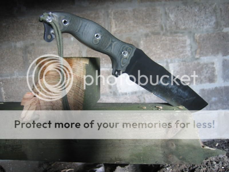

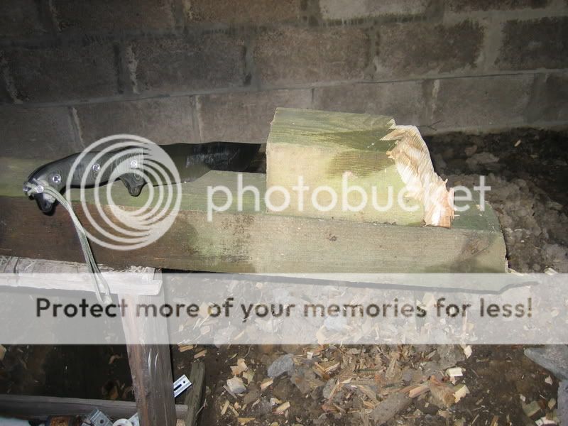

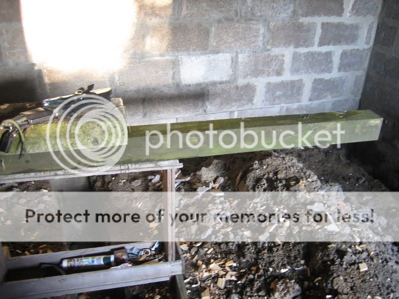

I did a quick test of the FFBM in the building site that will eventually be my workshop.
This was an old 4" X 4" pressure treated fence post (i.e it has had been treated with preservative)
I chopped directly through a large knot to make sure my edge would hold up.
I think I'll have to take the edge a bit thinner and try it again..... it is very sharp.. but.. it could be sharper.
The new handle shape is very comfortable.
