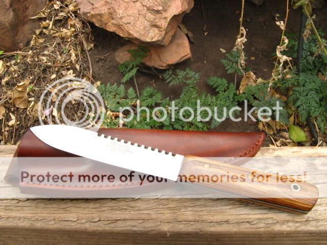

Anyone tried it? We have a local hardware store that sells Old Hickory and Tramontina. They seem to be pretty sturdy for outdoor use. Here's a pic of the Tramontina that they have http://www.costsaving2u.com/images/13467111.jpg. It's very comfortable in my hand, so I wouldn't mod the handle just get rid of the serrations. Only 4 dollars and change. I did order a Old Hickory Butcher knife and plan on experimenting with that outdoors as well.

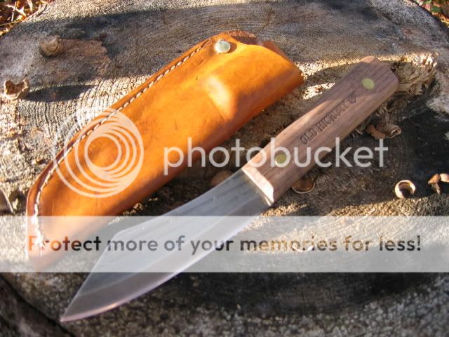

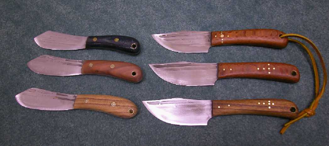

This is a little 5" Henckels Chef Knife that has come with me on a few camping trips...the only mod is a mulligan on the tip after I broke it...great knife though.
IUKE12 that is a great job on that Ol Hick...nice work.

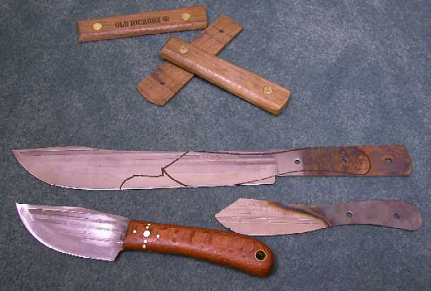

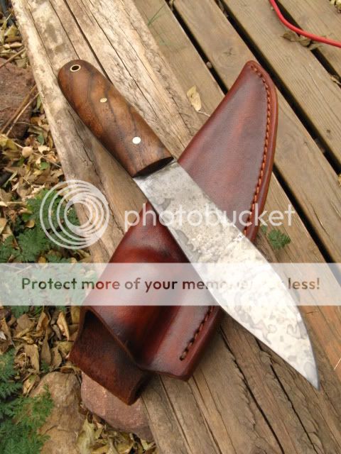

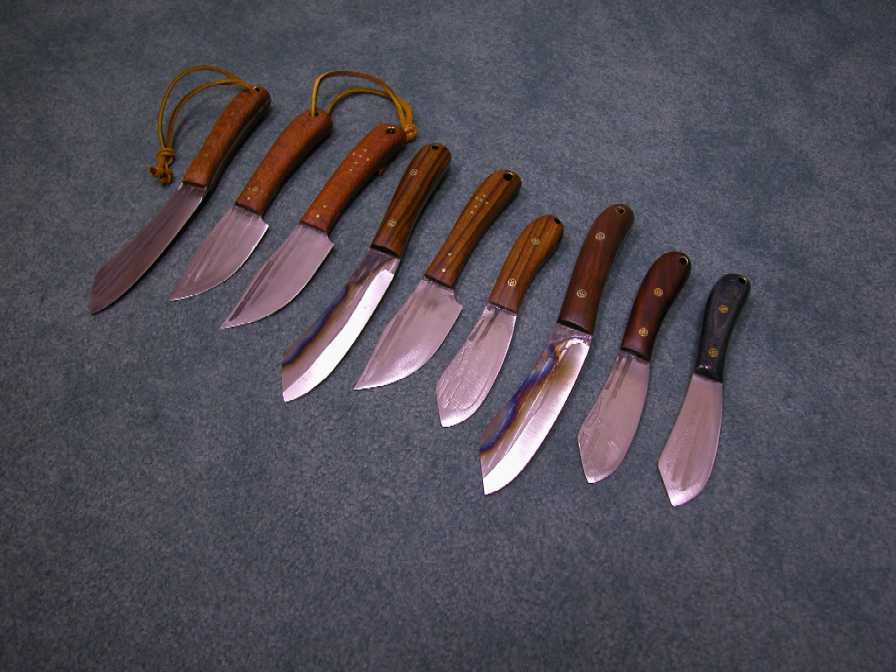

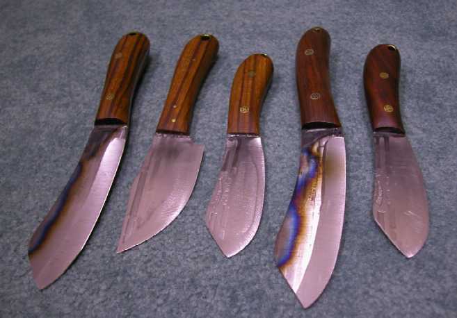

I love modding OH knives. That was a great stepping point into making knives for me.

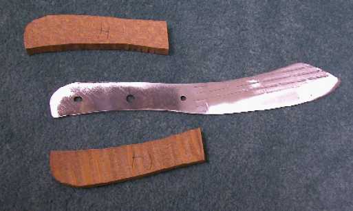

Take your time if cutting the metal. Keep it cool. Don't be afraid to knock off those awful burnt hickory scales, redrill some holes, and put on scales of your own. Also don't be afraid to regrind those edges either. Just go slow.

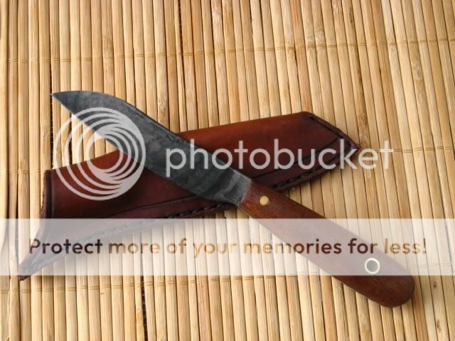

Here are a few pics.
Thanks for all the pics guys. I just go my old hickory butcher knife. If I get it done tonight then I'll post a pick. I especially like the Nessmuk mod on the OH Skinner.

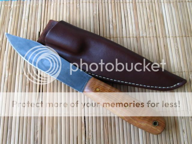

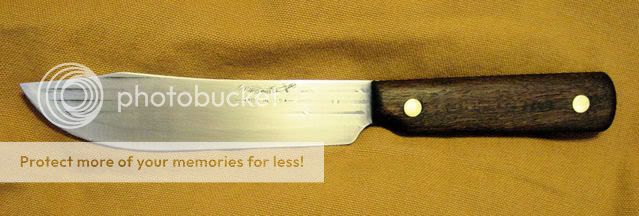

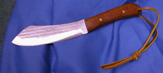

Well, here it is. I just had fun with this one and gave it a John Rambo look. The next one is going to be a Nessmuk design out the OH Skinner. The Old Hickories are fun to mod. I still need to get some leather and make a sheath. I'm thinking a piggy back sheath with a modified OH Paring knife.

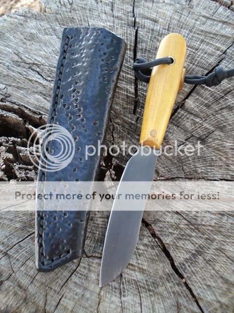

Here's my pretty basic mod. Choil, smoothed and rounde the handle, mineral oil handle, hair popping sharp. Haven't used it yet but it one of the most comfortable knife in the hand that I have. I haven't made the bottom one yet. It's a Photoshop creation. But I hope to make one like it. I don't really like the Nessmuk look. Mine current one is probably a little long.
