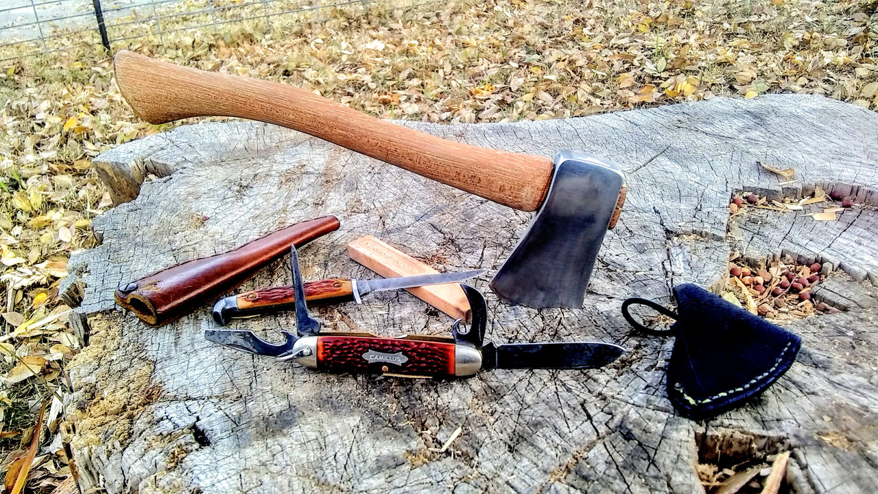

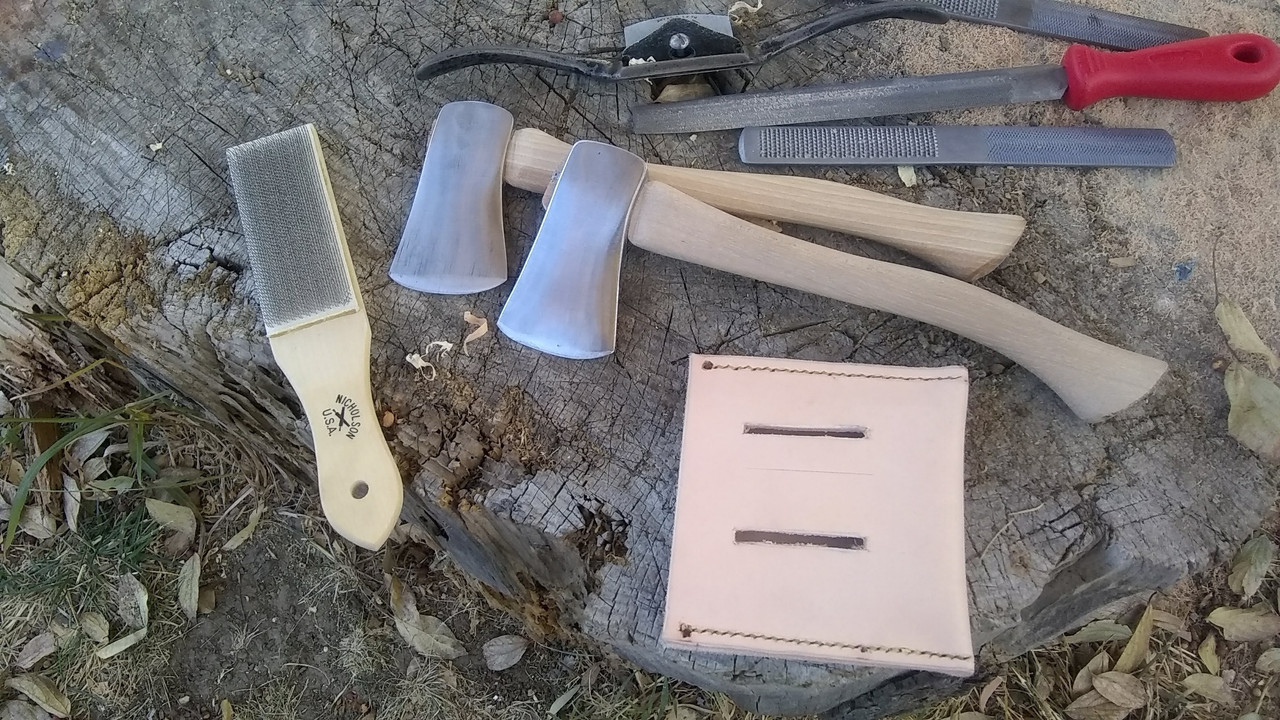

Heres a good example of what can be done
This is a little Vaughan sub zero super sportsman as they come from the factory.
And this is what I do to them.
