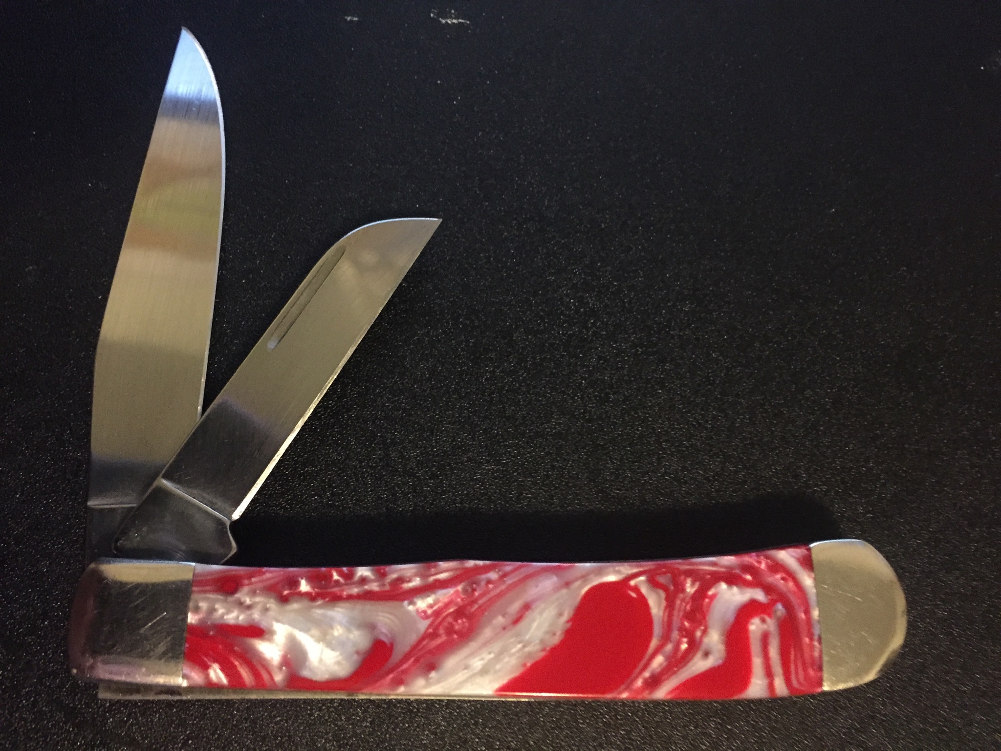

Here's a few Case blade mods I've done recently ...
Formed the pen blade into a mini sheepsfoot...
The Ratcliffe muskrat mod ...
Taking the excessive belly out of a trapper blade ...
Tidied up the point on the spey blade ...
