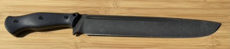

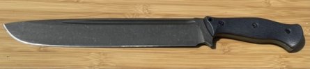

I put a pretty severe wiggle into my A2 Light Chopper prototype during testing years ago;
and it ended up looking like this;
That’s pretty cool though. Was the original tempered too low? What’s a good hardness for an A2 chopper?
A2 is not great for a chopper, although it is one of my personal favourite alloys. It's awesome for prototyping because it's easily machinable, available in precision ground stock and easy to heat treat well. It's really nice for small knives but for big mommas, 3V is your daddy
this prototype probably isn't full hardness, and tempered on the high side, which is pretty much the only way to toughen an otherwise not particularly tough tool steel
