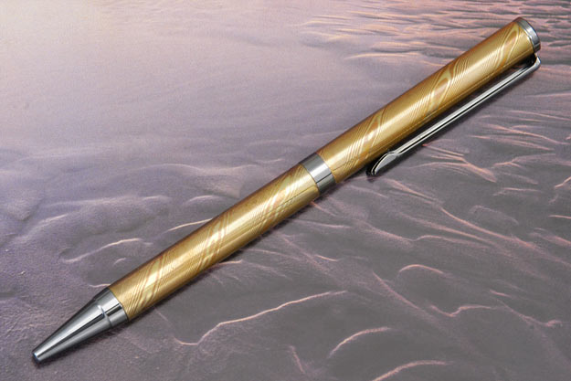

Well I didn't actually quit I just started using fine silver and shakudo or copper or brass and copper or nickle and silver or anything else that I know for sure what it is and figure out the liquidous point of the two. I did try the plate like you showed that it actually how I got the best results. this is not quarters but I think it is pretty cool
Bill
That is indeed pretty cool.

Bill, that pen is awesome.
