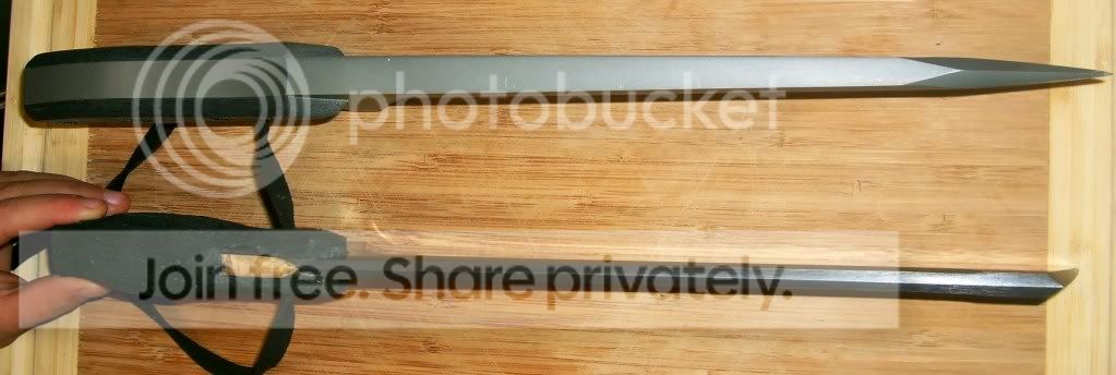

Will try to get pics of the first drawing tomorrow, I`ll put the ESEE 4 in the pic to show you the actuall size of this monster.
Xanra: I`m thinking of making it 10 or 12 mm thick, that`s 0.393 or 0.472 inch so yeah it`s going to the fat side alright, haha.

http://www.flickr.com/photos/63780000@N06/?saved=1
Trying to post first picture of the project.....
ESEE 4 on the side for size proportions....
PS: The white thing over the knife drawing, is kind of like a wiev from the top, lol, that is the 10mm one, but I think maybe I`ll go for the full 12mm.
12 mm is almost half an inch, so that would be über-cool, lol...
that knife is .310 at the thickest point. I can make one thicker. I have made thicker knives but for me they don't chop as good.

Bobber - nice design, since you used an ESEE4 for scale, it makes me think of a Junglas on steroids.
The tapered tang and distal taper should make for a nice balance.

Hope to get the chopper started tomorrow night, and I went for the 12mm or 0.472".
I also have the possibility to make the blade even wider, because the blank is 4" wide as is. But I think that would be taking it to far to the large side, it just would`nt look as good i think..
4" wide stock would be great for making a full tang hatchet after you finish the knife if you have access to a bandsaw.
