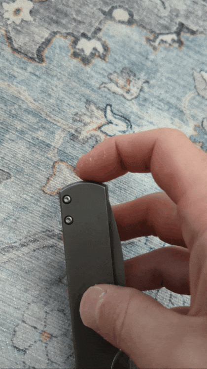

Let's talk lockup. After wearing in a bit, it did develop up and down lock rock. This is something I have found posted by others with other MBK framelocks. When I first got it, with the blade remove, the outer bevel of the lock bar naturally aligned with the inside edge of the handle. To fix the lock rock, I bent it in so that the outside edge of the lock bar aligns with the inside edge of the handle. That was enough to fix the play, it hasn't come back, and the lockup still looks good. Additionally, I carbidized the lock face, as I do with all titanium frame locks (this didn't change play or lockup). I didn't put a micrometer to it, but I'd say the cutout is thicker than a lot of framelocks because it took a lot of force to press over, much more than the other two knives I've done. I'll also add the locking sound from the factory was very dull from the lack of lock bar pressure, and moving it over has made it sound like others now. The detent strength is also more like I'd like it, also. Definitely recommend this change if you have one.

The thumbstuds are the second problem. They appear to be the #3 tactical thumbstuds from TiConnector. The issue is they stick out past the handle. That makes it really easy to flick or reverse flick, but the reason you don't see thumbstuds that stick out past the handle normally is it also means loose material of your pocket can easily catch them and lead to a partial opening (in your pocket). It happens easily in sport/exercise shorts, but it can even happen in like jeans when squatting down. The hole for the thumbstuds is smaller than most, or else like a Benchmade 940's thumbstud would be a perfect replacement. I plan to try the #4 thumbstuds from TiConnector, which are .160" long instead of the .200" of the #3s. I've had one other frame lock with thumb studs that stick out like this, and it is the only knife that has opened in my pocket--and did it multiple times before I relegated it to a benchtop knife. To be fair, I've had one partial opening with this knife so far, and it was also before bending in the lock bar (adding to the detent strength).

For a follow up 2ish months later, I still haven't bought new thumb studs, but the little beast did open in my back pocket again when a dog walk turned into a squirrel chase and sliced right through the pocket. Luckily I saw the sunlight shine off the blade as it was sticking out like a silver tail. Normally I use it around the house only, but that time I left it in my pocket for a quick trip for chores and a walk in a park.
Afterwards I took it apart and bent in the lock bar quite a bit, and that has helped both with staying closed and the sound doesn't sound awful and soft anymore when it locks. Instead of sounds like any other framelock basically, which makes me think the factory setting is too soft/low. It's about 90% lockup now though. I also still try not to carry it around when walking the dog (or going for a run--lockbacks only for that).
When I took it apart I noticed the lock bar was very dented on the corner and beginning of the face, much worse than any other ti frame lock I've had, and I have a lot that are much older and much more used. (I carbidized the lock face again. Hopefully it'll help keep the lifespan longer.) I also noticed the detent ball has flattened some; I replace all my steel detent balls with ceramic and have never had a ceramic flatten on me before, one of mine or from a factory knife, so that's a curious one. (To clarify, it came with ceramic and I am talking about the factory ceramic detent ball flattening in this knife.)
Ultimately I just wouldn't recommend one of these US-made production MBK frame locks. I like the knife and plan to keep it and continue to use it, but I just wouldn't ever recommend it to anyone.
