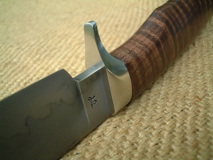

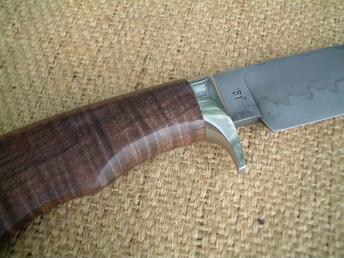

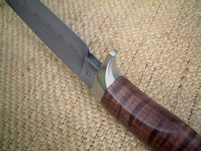

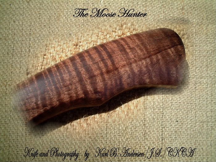

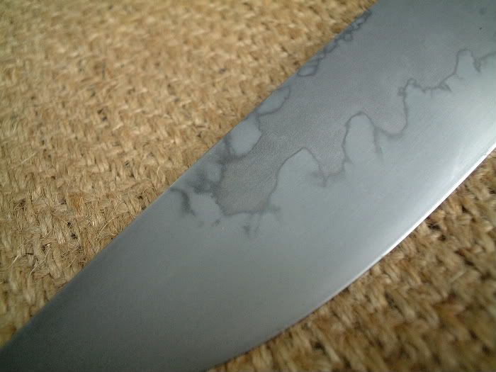

I had a customer in Sweden who wanted a hunter with a full 6 inch blade, and something "unique" for handle material.

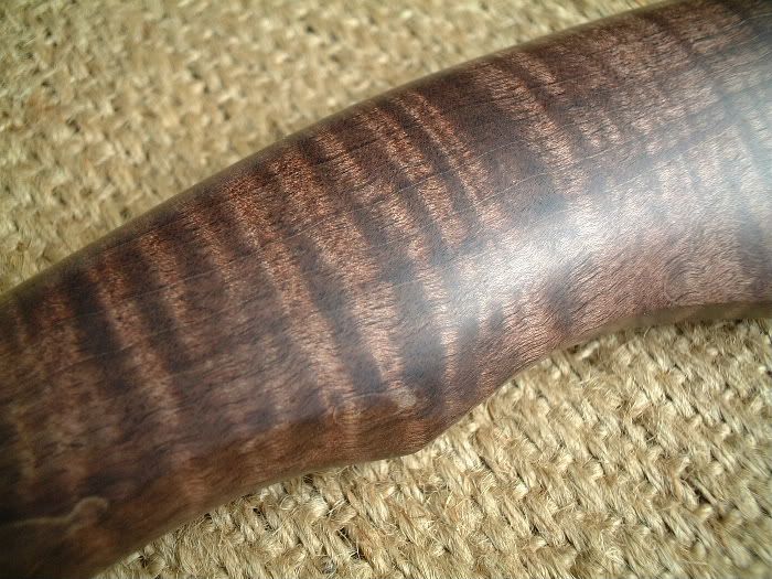

The timing was just right. I've had a nice selection of curly maple curing for about three years, and I've always wanted to have some dyed brown during the stabilizing process.
Wow! Was I pleased?!
The dying process took an already fantastic chatoyance, and kicked it up a notch. This stuff literally dances in your hand.
The single most active shimmer in any handle material I have ever used - and I've used a lot.

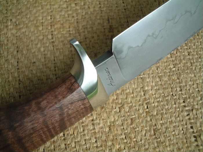

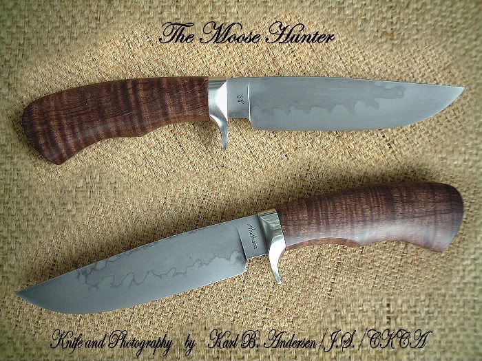

So, we showcase a W1 hunter with a 6 1/8" blade, stainless take-down fittings, and a stabilized, dyed, curly maple handle.
I'll bet it can handle any moose!
I also thought I would toss in some un-edited photos from the photography process:

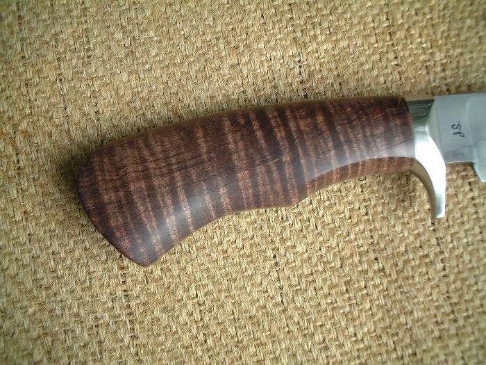

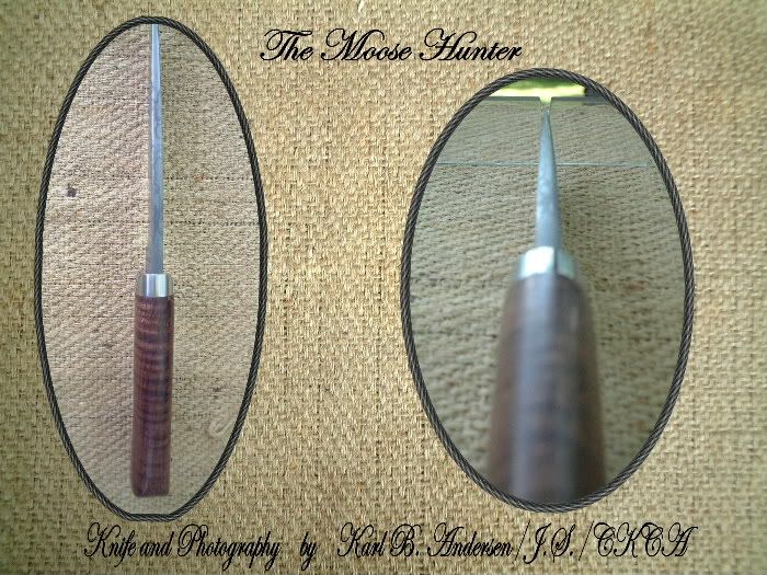

With all those cool photos, where are some of it in take down mode? I like the way the drop seems to start about two thirds back from the point. Is that where the distil taper starts too? Got a birds-eye photo looking down on the spine and handle?

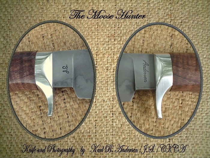

That's a big hunter all right but no doubt well suited to its intended task. This is what custom knives are all about. Well done my friend. I love the way the grind on the backside of the guard transitions into the underside of the handle. Sweet.
Roger
Tight, solid, virile, elegant and beautiful...as always Karl! The dyed curly maple looks like a cross between koa and walnut. Very nice!
Phil, I did take one from the top and it was out of focus!!!
The distal taper really starts right at the front of the ricasso.
I'll get you a take-down photo.

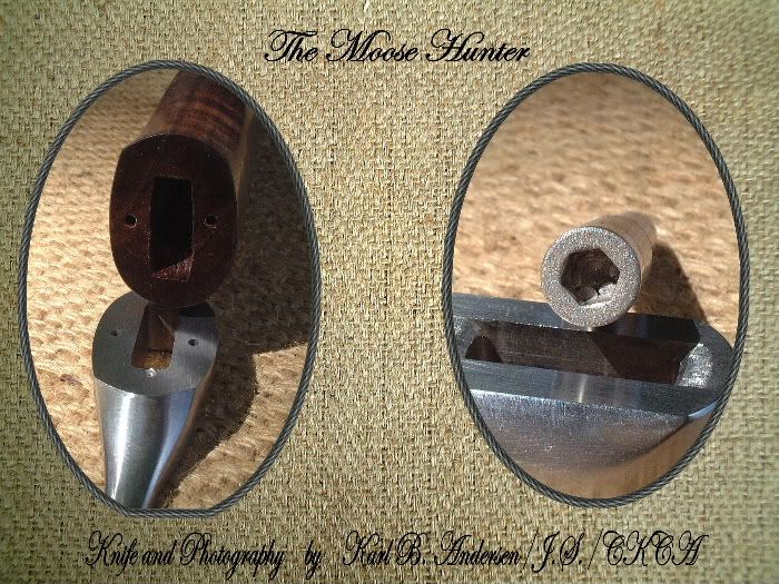

Here ya' go, Phil.
First you have to look at one more picture of that handle material:
Here's the knife all apart:
Here's the overhead view and the taper view:
The guard is right at .760" wide, and the handle, at the slight palm swell, is a little over .820",

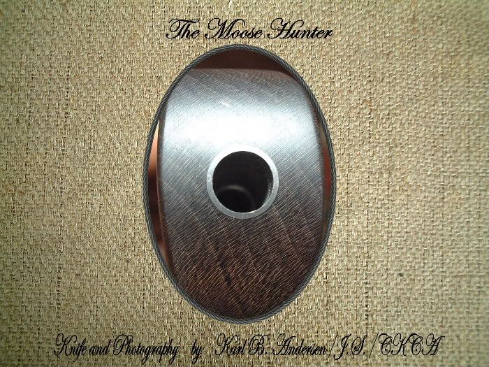

Here's the handle to guard fit-up. The 5/8" stainless dowel pins go .425" into the handle and .200" into the guard. The handle is file-fitted to the tang for no slop, even prior to pin placement.
The 5/16" 416 stainless finial has a 10/32, stainless steel socket head cap screw threaded into it and then silver brazed in place. I've been told that the silver brazing is stronger than the parent material.
I then turn them both smooth and give the face of the socket a Black Beauty sand blast for sparkle and to clean acetylene burn.
The finial "receiver" in the handle is a 3/8 416 rod into which is turned a "shelf" for the shoulder of the finial to sit on. This way there is only steel-to-steel contact in the rigid assembly.
The "receiver, itself, is setting on a shelf in the handle material so it can't go forward, and then epoxied into place.
During the assembly of all of my take-down knives, I assembly them with a pair of vise grips 30-40 times during the creation of the knife. I give them faaaaaaaaaaaaarrrrrrr more abuse than they will ever receive in the real world.

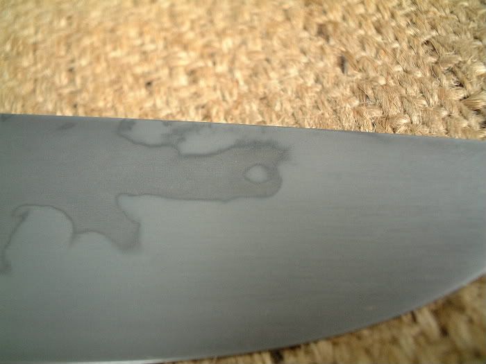

Great idea on the dyed and stabilized maple. It looks neat, as does the hamon and all else.
