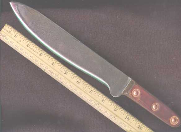

I have been carrrying a Mora 2000 as my primary bush knife for a year and a half now, and have come to appreciate this knifes ability to perform any job. It takes and holds a very sharp edge, and that high scandi grind cuts through even very hard wood with ease. In fact, using a reverse grip and pulling back, I can easily slice through 1.25" alder, and by cutting a notch first, can pull the blade through 2" alder. Combined with its battoning ability, I see no absolute neccesity for a chopper. ( although I allways carry one ;) )
Cliff, I know that you aren't that keen on the zero grind knife, due to the amount of metal that must be removed to re-grind an edge, but in my experience, this needs to be done so seldom that it is a non-issue for me. After flattening the bevels, I just keep it stropped with green chrome rouge, and very occasionally (maybe twice a year) touch it up on a hard Arkansas stone. I haven't damaged the edge enough to go any coarser than that.
In fact, the only compromise this knife makes, is the tip is more rounded than a standard mora. I assume that this was done to make it more useful as a skinning blade. It does skin well ( though it cuts through the hide too easily ) but there are times that a more acute point would be handy. I really like the handle, it fits my very large hands well, but my 16 and 12 year old sons like the handles as well. I even like the sheath. It is secure, strong, doesn't rattle at all ( at least non of the three we have ), but still allows an easy draw and resheathing. I spend a lot of time in the bush, and demand a lot from a knife. I use them hard, but take care of them. It will take quite a knife to supplant the M2K.
Thombrogan, Who makes the knife in the picture you posted? Is there a website? Thanks.
Ant down sides to the factory sheaths have been aptly dealt with by ON Scene Tactical Eric is producing a sheath that take the combo up the notch it needs to go.
