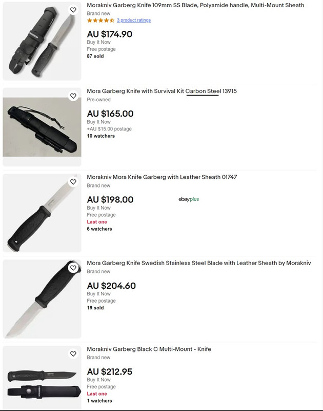

If this was a $50 knife , ( Australian ) , I could understand . But it's selling for up to $300 Australian bananas ... I paid almost half that and I think I over paid quite a bit . ( Over priced & underperforming comes to mind )

This is not an inexpensive knife. I've been disappointed in the edge this knife has from the factory, and I'll be interested to see what further testing tells you.
It's not dirt cheap, like a 511, but by BF standards, I'd say anything under $100 US is an inexpensive knife.
Yes , the USA ..
But we pay about double down under .. .. And sometimes more .. So that affordable knife in the USA becomes a little more pricy in Oz ..
Sure , we can also buy from the USA but then you need to factor in 10% GST and shipping , which is still often cheaper than local ..
Butt & it's a huge butt ! Not everyone ships to the Oz and some postage scalp ... Sooooo ?
