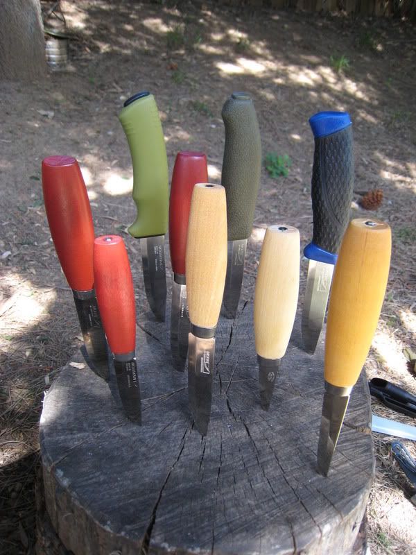

As far as I know, the carbon are carbon, the stainless are stainless, and the triflex is carbon with softer laminates. They also have "original" moras which are laminated carbon steels but I don't know what the laminates are. Its pretty exciting to get a new user for $10 bucks, I just ordered the #1 and 711G both in carbon last week and am eager to use em. Its also a relief after spending the kinda money I spend on customs and high end productions.

This maybe one of the oldest thread necros in history so just want to be part of the action. In any case I have a 746G and 711G and think these have a very comfortable handle. Also they can take a beating better than some people might expect give the cheap price

...and six more on the way.
