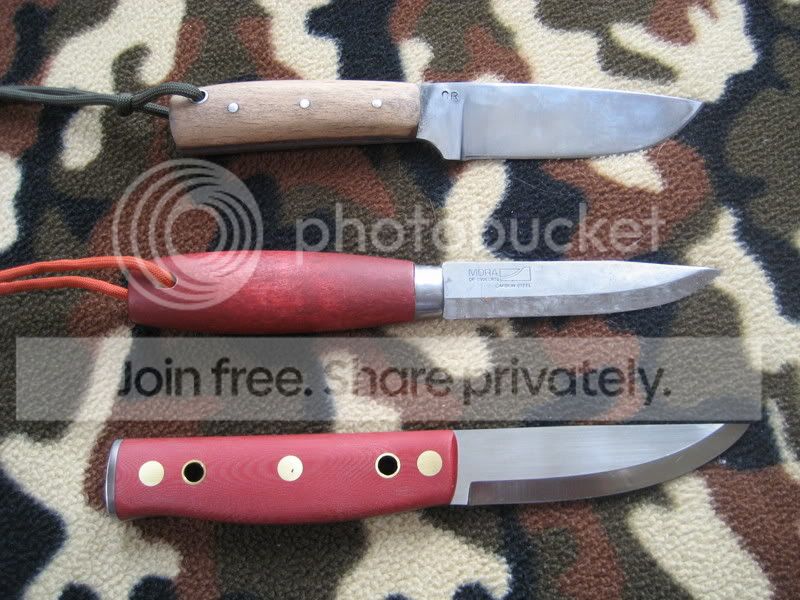

Random pic with my Skookum:
Top down shot:
The custom is a very well put together drop point, thin in stock, and has a "use me" look to it. My only complaint is the handle is a bit small for my hands.

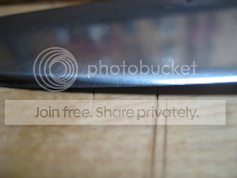

It needed a good edge so I used the water stones first, and then convexed the edge a bit:
Edge:
Result:
Despite the small handle (for my hands anyway) it's well made and a fine user so far.

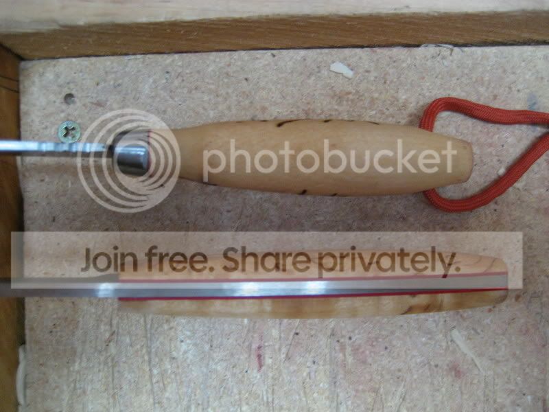

The # II was begging for the spine to be squared off so out to the shop we go....
The before:
After with some thumb jimping:

Nice. I was sick and half out of it, when I shipped 'em, and forgot to sharpen Mark's knife. Forgot to leave a mark too. The edge of that Mora looks interesting. I believe I need to clean my stones :o.
Nice. I was sick and half out of it, when I shipped 'em, and forgot to sharpen Charlie's knife. Forgot to leave a mark too. The edge of that Mora looks interesting. I believe I need to clean my stones :o.
The Mora is quite sharp. After the testing I'll throw it at my water stones and clean it up. The custom is now shaving sharp.
No big deal really. Gave me an excuse to play with my stones.......:confused:

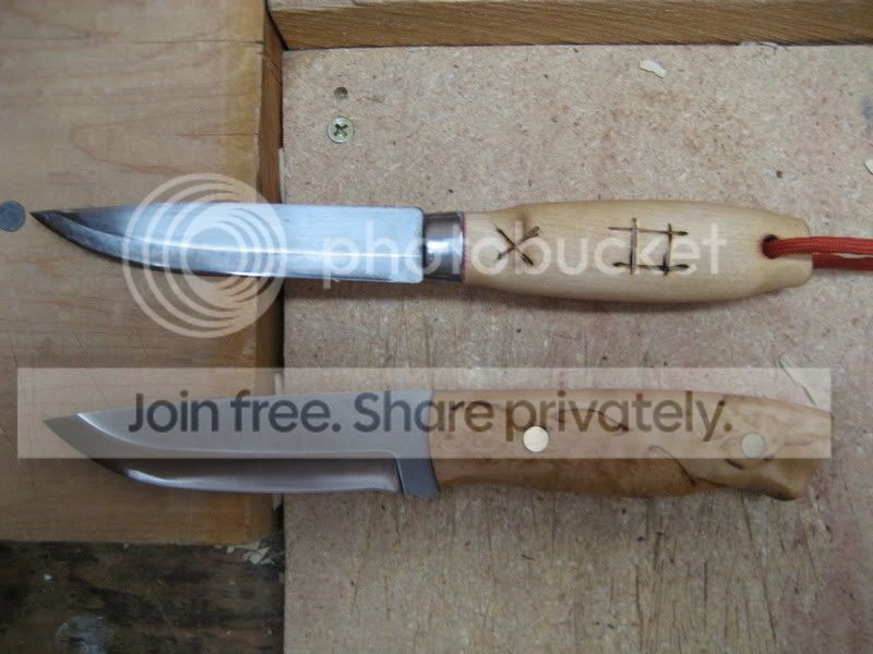

Flame treating is really easy. It removes the ugly paint, and raises the grain for a good tacky feel. I use a butane torch, and from a distance of about 5 to 6" away I slowly go over the handle. You want to see the paint bubbling off, but not a full on fire of course.
Once the paint is removed, I used my belt grinder and a 110 belt to re-shape the handle a little.
Then just for fun I used a old piece of sharp metal and my torch to mark it up a little.

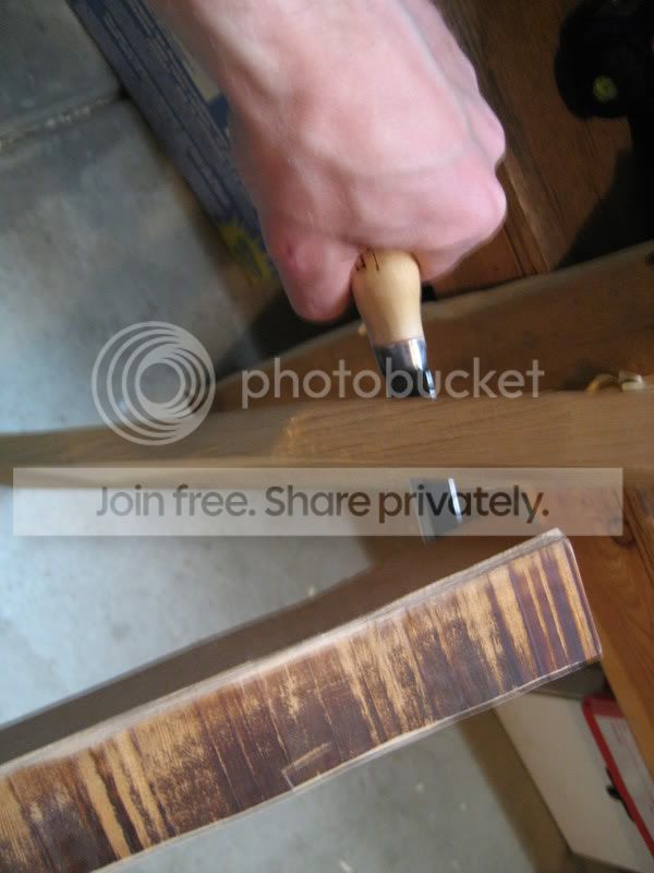

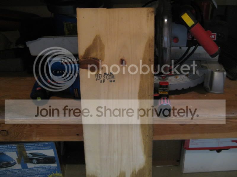

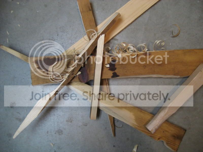

Then I reduced a pine board (only spare wood I had) into stick using a baton.
