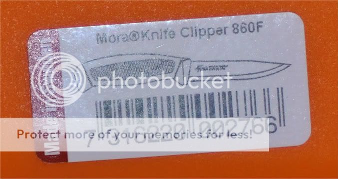

Hi gang, I just got my first Mora knife!:thumbup:
It feels pretty dog gone good for a fifteen dollar knife. The handle is very comfortable and grippy and the blade is razor sharp.
It is the 860 F, which I believe is the stainless steel version.

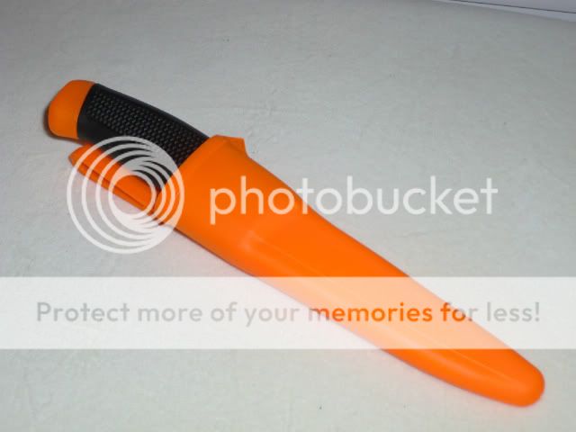

My question for you is the sheath is great and bright but it has no retention what so ever. If you hold it upside down the knife will slide out.
It is a plastic sheath I believe so I dont know if you can heat it up to improve the retention or is it a lost cause?
Thank you for any help you can give, I really like the bright color of the factory sheath.
Yes, you can actually heat these ones up and make them tighter. I first tried my heat gun but it melted pretty quick. But the wife's hair dryer worked great. Just go slow and don't let it get super hot. Squeeze it in a little when it's malleable and you will be good to go.
I am NO fan of molded sheaths, whether they're kydex or generic plastic, but of all of them the Moras seem to be the least rattly and loose, and the best at retaining. Maybe the knife isn't pushed in all the way, or you got a melon. The 860 is indeed Stainless. I have the OD green version and it makes for a killer kitchen knife. My roomate and both like to cook, and it feels alot more manly when you're dicing veggies if you do it with a Swedish survival knife :)
TKnife's hair dryer suggestion is a good one. If you want to take it a step farther, spend half an hour soaking some black paracord beforehand, do a hangman's knot around the molded retaining portion of the sheath, and the paracord should keep the round plastic nice and tight.

I glued a small strip of belt leather inside the throat of the sheath as a retention bump. Works fine.
I have the same model and it has incredible retention, but you do have to seat it pretty hard to get the click as it locks into place.
The photo does look as if the blade is fully inserted, so maybe there was an issue with the moulding on that one? If there's an issue getting a replacement sheath, I'd try the hairdryer route, but my knife supplier in the UK is pretty good about replacement/warranty issues and would send one out
