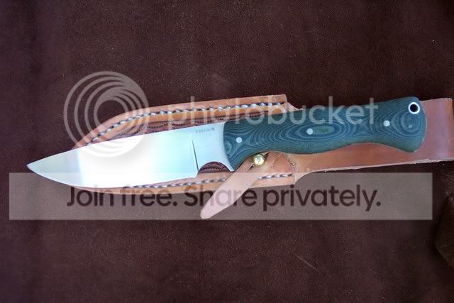

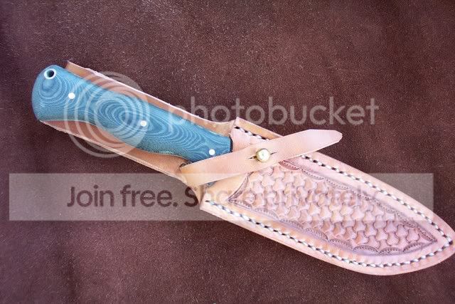

Here are a couple i finished last week..01 tool steel,6 inch blade ,+/- 11 inches overall, flat ground convex edge, hand rubbed 400 grit finish,micarta handles stainless fittings,hand stitched 7 oz leather sheath.
Here she is all dressed up..

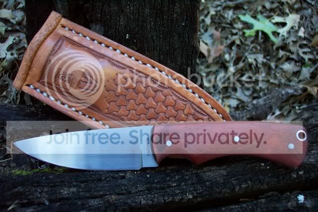

heres another one of my medium utility blades..01 tool steel, flat ground convex edge,hand rubbed 400 grit finish,bloodwood handles,stainless fittings,hand stitched pigskin lined tooled 7 oz leather sheath..
How about some more info on this bad boy. Blade length, RC hardness, price.:D:D:D
This one is nice, definitely a keeper.
That top one is perfect. Do you have a website with more pics. Me thinks I've found my next custom project.
Thanks for all the kind words guys..much appreciated..there are some other examples on my websire swensonknives.com..i dont know if i can post that here.. the second knife has a 2.75 inch blade and is approximately 7 inches overall. The RC on the smaller is right around 59 I do the smaller blades a touch harder than my camp knives. the top knife is the same Rc as i heat treated them in the same batch..thanks again fellas..this kind of talk will keep a maker going..later Luke
