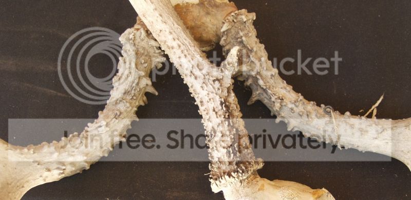

This is some antler that was stashed in the barn here. My boss cuts them up to make cribbage pegs. I grabbed these because it had all those weird bumps all around the base.
Would this be good handle material?

It'll make great handles, for a using knife most of the points need to be sanded mostly smooth though.
Burl Source was nice enogh to supply me with some of this antler. I'll do a tutorial on dyeing antler if anyone is interested.
That antler is fine handle material, the wierd bumps are sometimes called "popcorn" and people like it. It will be fun to see how good these turn out.

The antler actually felt good in hand in spite of the bumps (popcorn). It will be fun to see what comes of these pieces.

Next comes the quality of texture. Popcorn and grainy wavy bark is pretty exciting. Not only does it look cool, but usually adds to the handle's grip.

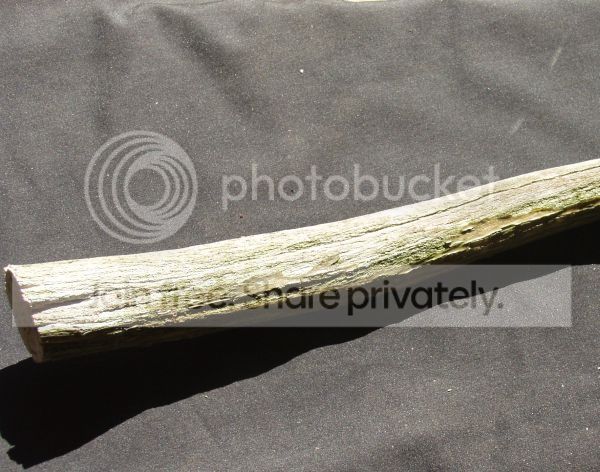

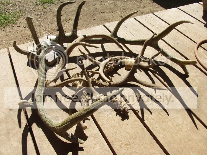

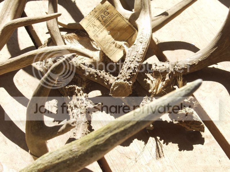

You guys have to be careful about encouraging me to get different stuff. I tend to get carried away. Today I am working but there was a garage sale about 100 yards down the road. There was a huge old elk rack that was disgusting looking. I hope Phil was correct with what he said about the old abused stuff. I will do a little cutting and sanding to see what it's like. I also searched the rafters of the burl cap barn and found some more interesting old deer antlers. One of them has a 1965 deer tag still attached.
This is from a portion of the elk rack that was in the worst shape. I am going to cut it up and sand some to see what's there.

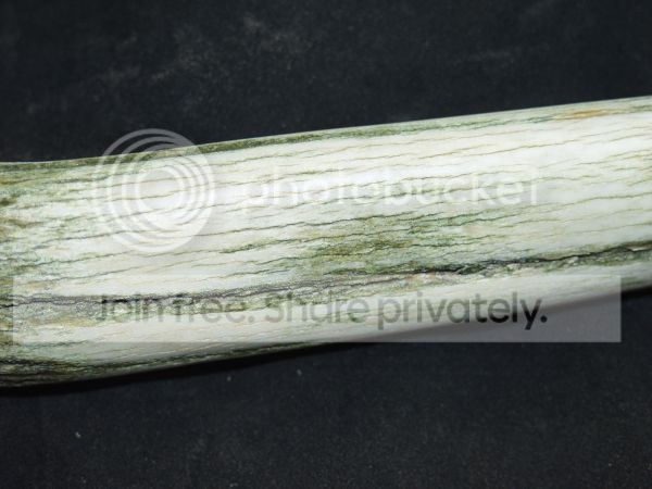

Here is when I began so sand through the crud.
If I get good handle pieces I have no idea what I should charge if I sell some. Any ideas? I know it would only be a fraction of what stag sells for but I am still clueless. Any input you guys can give will be greatly appreciated.

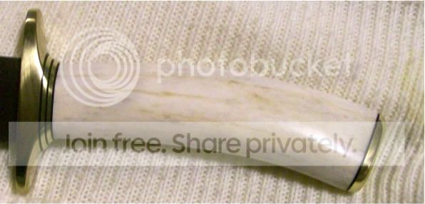

Hear is a Bowie handle I recently did with polished Elk.It was a pretty rough looking piece.I sealed it all over with thin CA glue and polished to 1000 grit and then used white rouge on a clean wheel.It looks much better than this picture with my old camera.
I was a little worried about the thin walls.They were only about 1/16" thick with a lot of pith inside.I removed all the pith and filled the entire handle tang area with accuraglass.This was a big 10" blade 2" wide and I have chopped a lot testing the handle material.It has held up fine now for several months of heavy chopping with full strength swings in hard wood.http://
