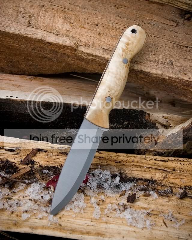

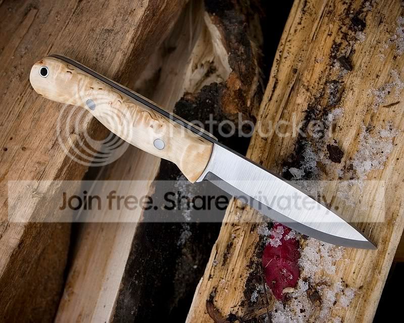

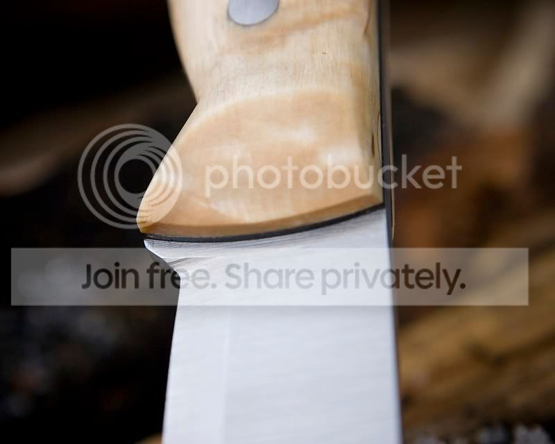

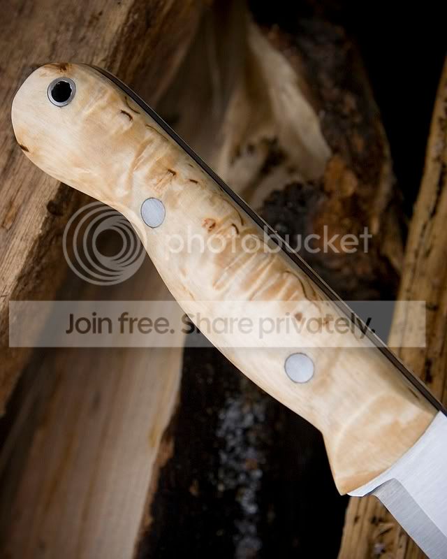

I had a really hard time parting with this one, but it is off to Marcelo. You lucky dog......I nearly didn't tell him about this one, and kept it for myself :D
If you notice a touch different grind on this one. It is still a 1/8" knife, but I have decided to back my grind off to 12.5 degrees per side. It is still scary sharp, but my tests with this grind angle has been very good.

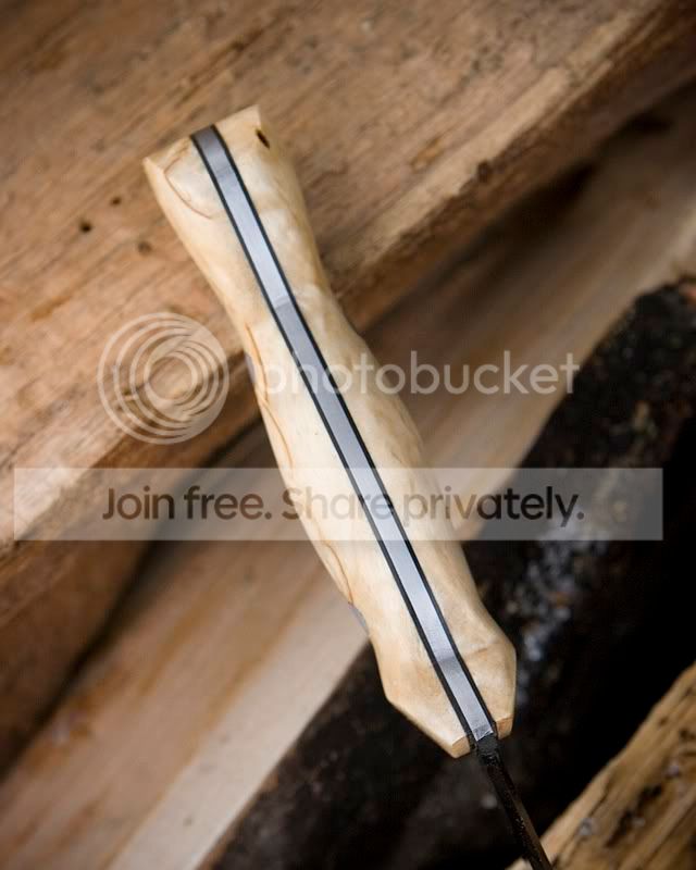

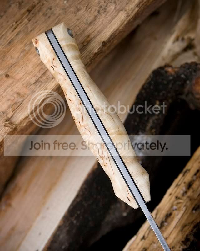

Black liners, and someone else previously mentioned might look good. I agree!
JRE hooked me up on some very nice dangler and non-dangler sheaths.

duuuude...:eek: brian that knife is a beauty... i love the handle scales..:thumbup: you're going to be a busy man, if you keep putting these pics up...

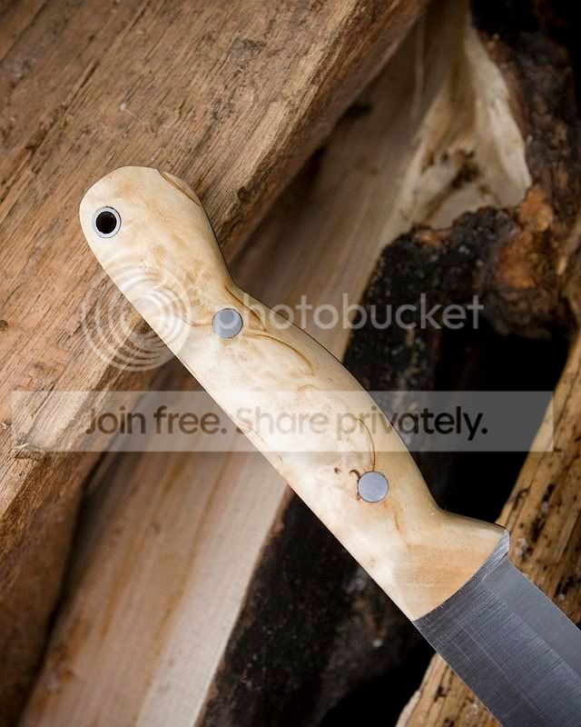

Really, really great job. I especially like the angle you put on the scales as they approach the blade.

I think backing off your grind is a good idea - I think 1/8th inch knives can suffer from weak blade profile at the tip if the grind is too shallow.

Fantastic work Brian! :thumbup: Thie birch and the black liners are just the
