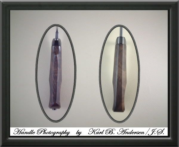

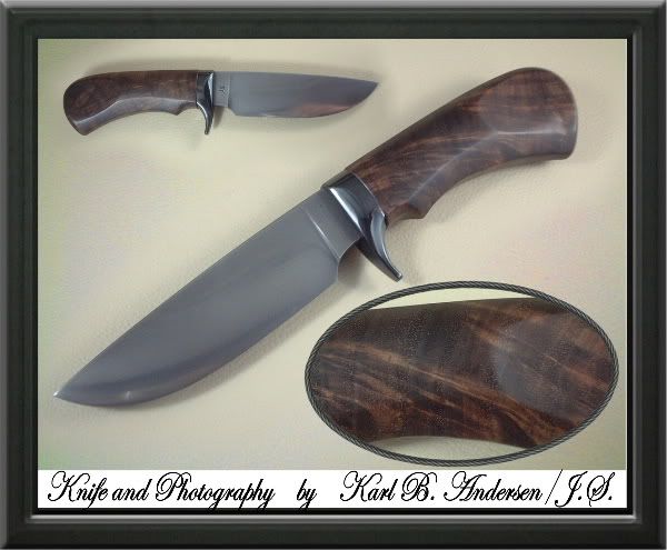

This is another piece of Walnut that I salvaged from a demise of doom in the fireplace!
While splitting some firewood to sell two years ago, a friend of mine discovered a piece that had some strage "goin's on" inside it!
So, I cut it into blocks and dried them in the ceiling of my shop for two years and then sent to K and G to be stabilized.
My customer chose this one for his 5160 hunter to use in Colorado where he lives.
Hot blued guard and finial in a take-down assembly.
I just keep wishing I had a truck load of that walnut!
