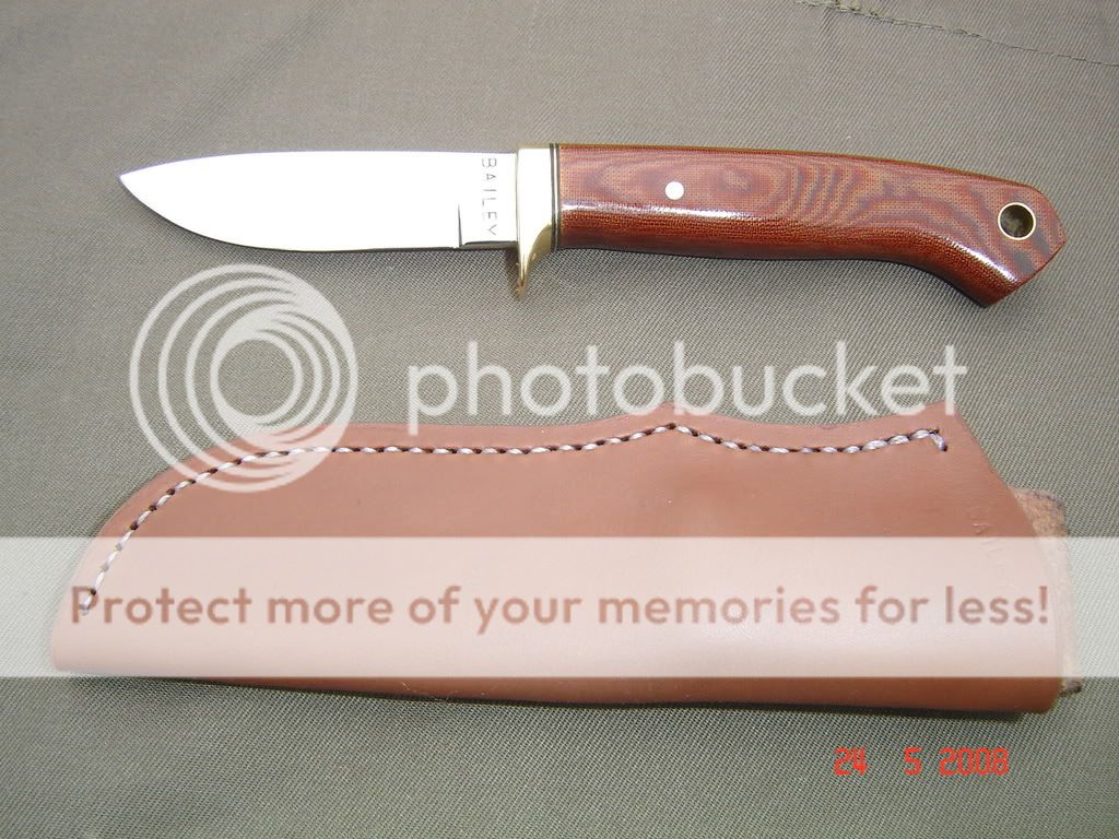

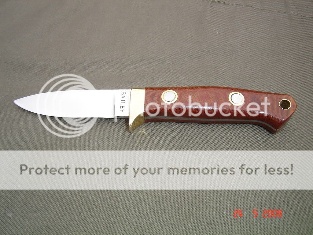

Full tang micarta 3"
Stub tang micarta 3"

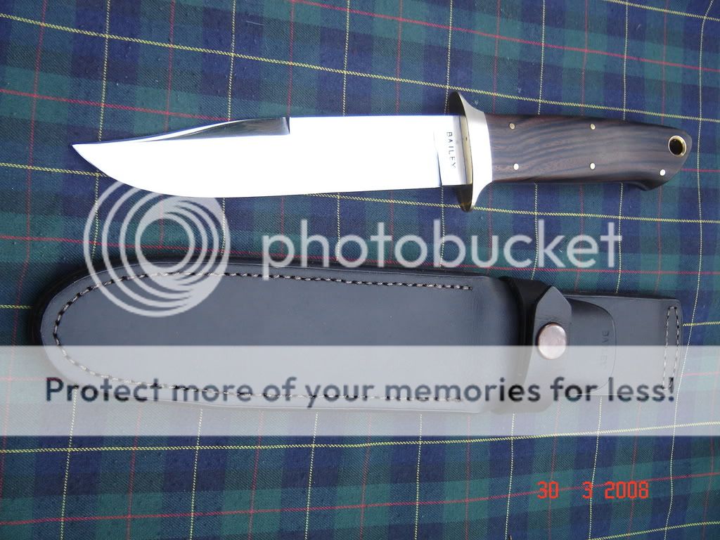

7" Fighter maccassar ebony

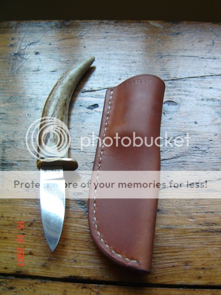

2" stag tine

Let me know what you think, good or bad!!
Cheers! The pins are a bit of an experiment really. I threaded some steel
rod (8mm), and then threaded 4 pieces of the brass tubing I normally use for thong tubes, and tightened them all up.
With hindsight I should have cut them with a finer thread, because as you can see the threads are visible after the handle was ground to shape.
Still, live and learn eh?!
The knife is a bit tatty because it has been my work knife for the last six months, and has done some hard work stripping armoured cables!
