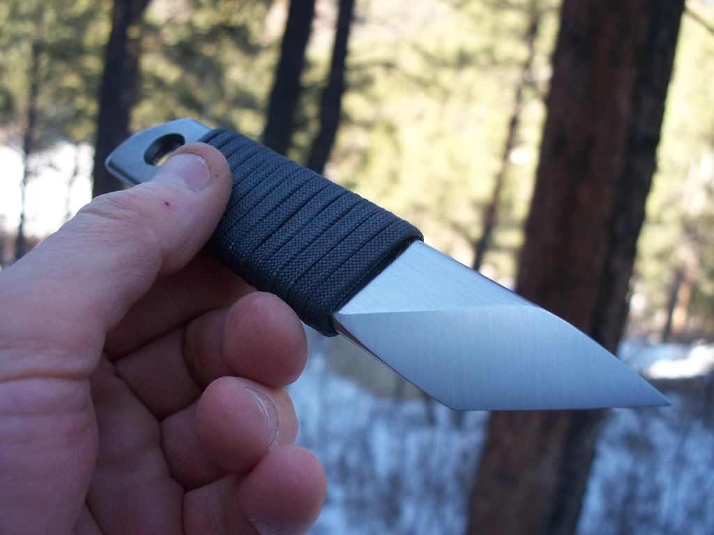

Oh yeah, pics! :D Here's the general design!
They are roughly 6" long with a near zero bevel chisel main grind on one side and a small microbevel on the back for ease of sharpening. They have a forge finish that is usually browned for super toughness and durability.
I round the spine and bottom as well as the butt of the kiridashis, these are older ones in the pics... I think the newer ones are chamfered a bit more. They are left solid besides one hole so they are super tough and as heavy duty as a kiridashi gets.

Here's a more recent one with my new double/gutted paracord wrap, the old one was single full cord.
The Coyote Brown with the antique browned finish is probably the most popular version.
