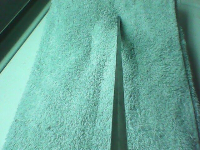

This is what I mean:
Machine made blade with straight mune. The center line is parallel to the other two.

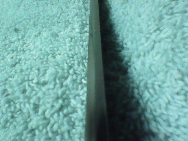

Hand-forged blade. The mune does not take a perfectly straight path relative to the edges of the blade...

Actually, that sword in the second picture is simply bent. As has been said, a properly polished and maintained sword does not wander back and forth like this...

Really? :confused:
I think you're jumping to a conclusion there. I don't want to bust your bubble, but the sword I'm looking at is not bent; it's freaking hand-forged. If you're having trouble with the poor quality of my pictures, that's one thing...but there's no reason to insult my sword.

Being hand forged has nothing to do with whether it has ever been bent or that the mune ridge wanders. ALL genuine Japanese swords are "Hand Forged". They can be bent, broken and poorly polished. Again, WHEN PROPERLY POLISHED THE LINES WILL BE STRAIGHT AND CRISP !!
