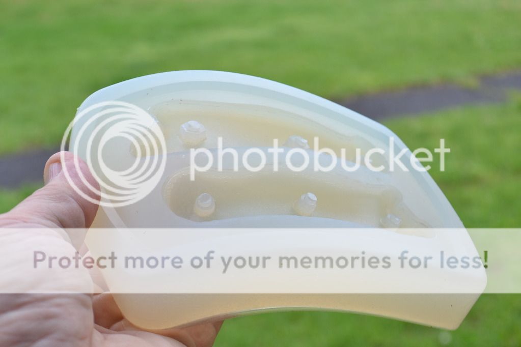

The first mould I made was for Tweener scales. In two hours from liquid to this...
The mould is downright floppy -- until you set it onto a table for the pour, and it firms up more than enough.

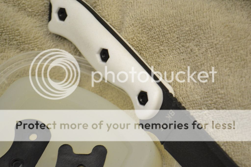

For my first scale pour the first actual medium I had was some stuff I bought at a crafts store. It turned out to be a polyester-based epoxy, very fast setting (10 minutes) but the strangest part is it mixes up clear, but hardens white. You can actually watch it turn white in the mould. I released the white scales from the mould, sanded down the side facing the knife to make it flat, trimmed the flashing, reamed the holes, and mounted them on a BK15. I actually kind of like the white against the black.
It may be obvious in the photo, but "my" scales are significantly thicker than a stock scale. One of my disappointments in the Tweeners was the thickness of the scales, so now I'm happy! ;)
Notice a pair of stock scales sitting in the mould just so the cavities would show up in the photo.
The poly material is just OK. It is not very hard -- not in the sense that it is rubbery -- but in the sense that it feels like it might dent easily. Maybe I'm just used to the feel of the super-hard Grivory.

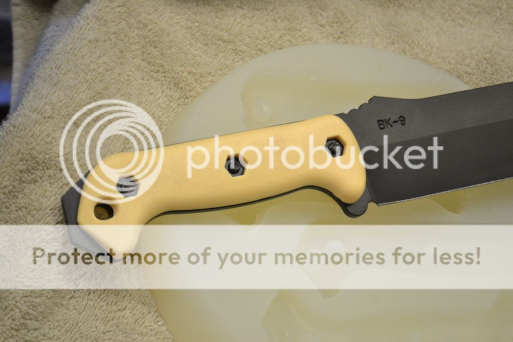

And here are the flesh-colored scales on a BK-9. Note the dark circle between the front and middle screw holes. I have no clue what that is. It doesn't sand out, it's not a bubble in the poly or it would have broken through. There is nothing in the mould that corresponds to that area. One of those mysterious things. Let's just call it a birthmark! :D

Also, there is a darker patch on the second scale as well, not quite as noticeable, but still there. I think the reason it's dark and doesn't just sand out is just a little closer to being dried, you did say it's supposed to dry nice and clear.

Um-m-m. No. This is the white-drying stuff. The 72-hour stuff is the clear one (as is a third type I have on order to try -- clear AND rapid drying).
That said, unless the master is perfectly smooth (and Grivory isn't), the mould material will pick up EVERY tiny rough spot on the surface and transmit it to the finished piece. I foresee clear-ish scales coming out, but not perfectly water-clear. It did, for instance, pick up areas that had been sandblasted on the Tweener scales and the roughness showed up on the finished 72-hour piece.
