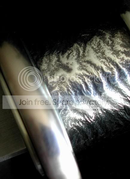

Here’s a piece of reticulated sterling silver I did a few days ago for a knife I’m working on. It’s from a rolled sterling silver coin.
I assume reticulation is the texture?? How did you accomplish that?
Neato, btw!
Basically, you start with a piece of copper bearing silver alloy, like sterling or coin silver, about 20 gage or so. Then you heat the silver until a black layer of cupric oxide (copper) forms on the surface, and then pickle the oxide and copper away. After you repeat this process a few times you will begin to build up a thin skin of “pure silver” on the surface. Once this is accomplished you heat the silver with a torch or other heat source until the core, which melts at a lower temperature than the skin, buckles and "reticulates" the piece. The internal alloy melts before the surface skin.
It looks similar to the earth's crust and like an aerial view of the landscape, if you do it right.

Andy, Pickling means to clean the surface using acid. I use a jeweler's pickling compound.

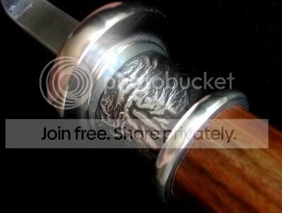

David, I'm going to use it for a ferrule... bend it into an oval and solder the seam. It will be supported on the inside with the wood of the handle and protected by the guard on one end and a raised sterling silver ring on the other. It’s for a big bowie.

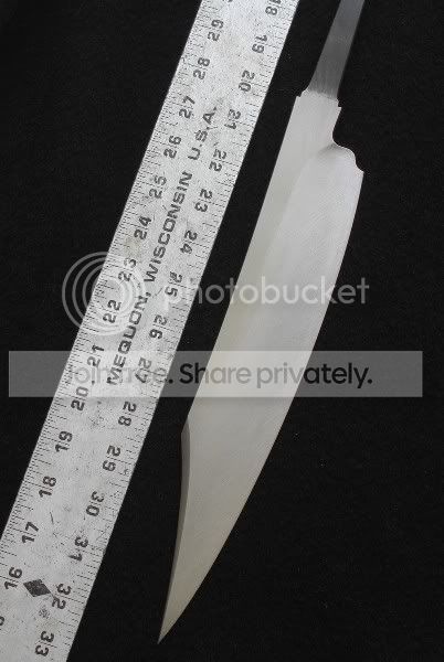

Here’s a little teaser of what I did with it, and a shot of the blade it goes with:

Since I'm sure everyone wants to see the seam, here it is:
The handle is going to get wrapped, so in the final analysis the wood isn't going to show.

By making an alloy of copper and silver,or copper and gold,the alloy becomes amenable to reticulation. 20/80% copper/silver ( coin silver), and 25/75% copper/gold (electrum) work well. As Tai stated, the repetitive annealing ( 10 to 50 cycles) and pickling ( soaking in sulfuric acid) of the piece creates a fine (pure) metal shell that traps a eutectic alloy core. This part of the process is called depletion gilding, and is used to create a bullion color on some jewelry. When the shell is of sufficient depth a final carefully controlled heating ,with a hand held torch,will allow the core to melt before the shell. The resulting contraction of the molten core causes the thin skin to wrinkle and distort. Torch control is the key here. Too much and it is a puddle,too little and nothing happens.The resulting reticulation can be subtle or dramatic. (The mechanics are somewhat similar to the way the sori forms in a Japanese blade.) Thickness, alloy, shape,number of quench cycles, and torch control allow a great variety of structures to form. Every one is individual, and can not be duplicated.

I used a little oxy/mapp torch for this piece, which seemed to work just fine. I've had the best luck with a hot oxidizing pencil flame. Coin silver reticulates easy, but reticulated coin silver tends to be brittle in fabrication. I use sterling more often.
