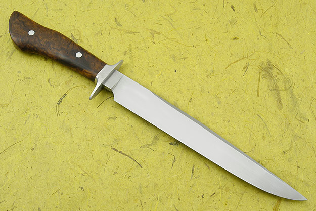

Hey Ryan, I was thinking about it, isn't this the knife of yours that I made?
Well, its handle was made this exact same way (about 7 years ago! where's the time go?!?!)
that's not it nick....i'll go find a pic of the knife i own of yours...i bought it from the owner not you....ryan
this is the one i own....i have been tempted many times to use it!:eek:..i've always wanted to just whack into something with it....it has a great feeling to the handle...the countours on it are perfect.....it reminds me alot of my john fitch hunter...now that guy can make a serious handle....it has a beautiful paul long sheath it resides in too....ryan

Oh that's the one! Okay, that one's only like 5.5 years old :D, and is NOT a mortised handle, lol :) Thanks Ryan! :)
